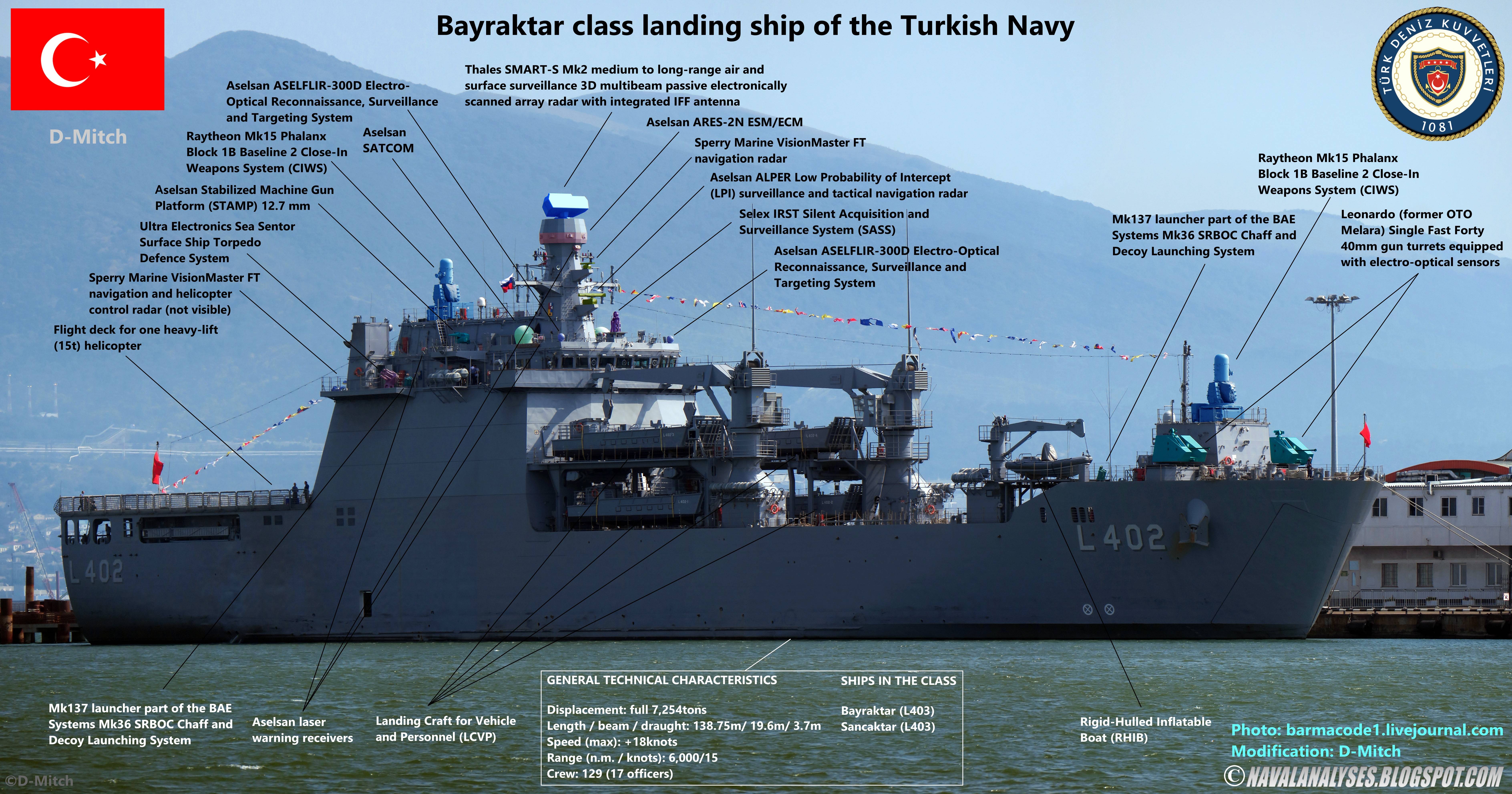

The LSTs incorporate an upper-intermediate-sized mono-hull design made of steel. Each vessel is designed to meet the sea-keeping and stability requirements of the Turkish Navy, and will have an anticipated service life of 40 years. The ships will comply with the IMO MARPOL 73/78 and Safety of Life at Sea (SOLAS) regulations. The ships can operate seamlessly at Sea State-5 conditions and can also be operated at Sea State-6 or higher, with limitations. Additionally it will support limitless helicopter operations at Sea State-4 conditions. The load carrying capacity is 1,180t, including a mix of vehicles or cargo on open decks and specifically they are capable of transporting up to 18-24 tanks depending on their size and between 24 – 60 vehicles.The closed parking area is 1100 square meters and the open deck parking area is 690 square meters.
Modified photo of a Bayraktar class landing ship of the Turkish Navy. For a high resolution image click here.
The Turkish ships, except the very modern electronics and sensors, carry also a heavy hard-kill and soft-kill defensive armament which will be described in the next paragraphs.
