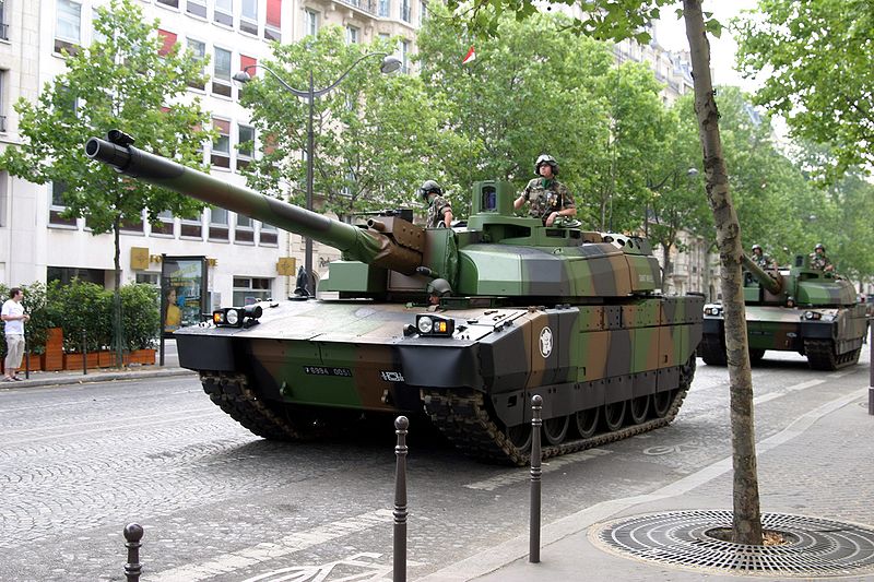

![Leclerc-14july_Bastille_Day_Parade.jpg](/proxy.php?image=http%3A%2F%2Fwww.tanks-encyclopedia.com%2Fmodern%2FFrance%2Fphotos%2FLeclerc-14july_Bastille_Day_Parade.jpg&hash=0af113dbee861f15557d8c64aaf38516)
