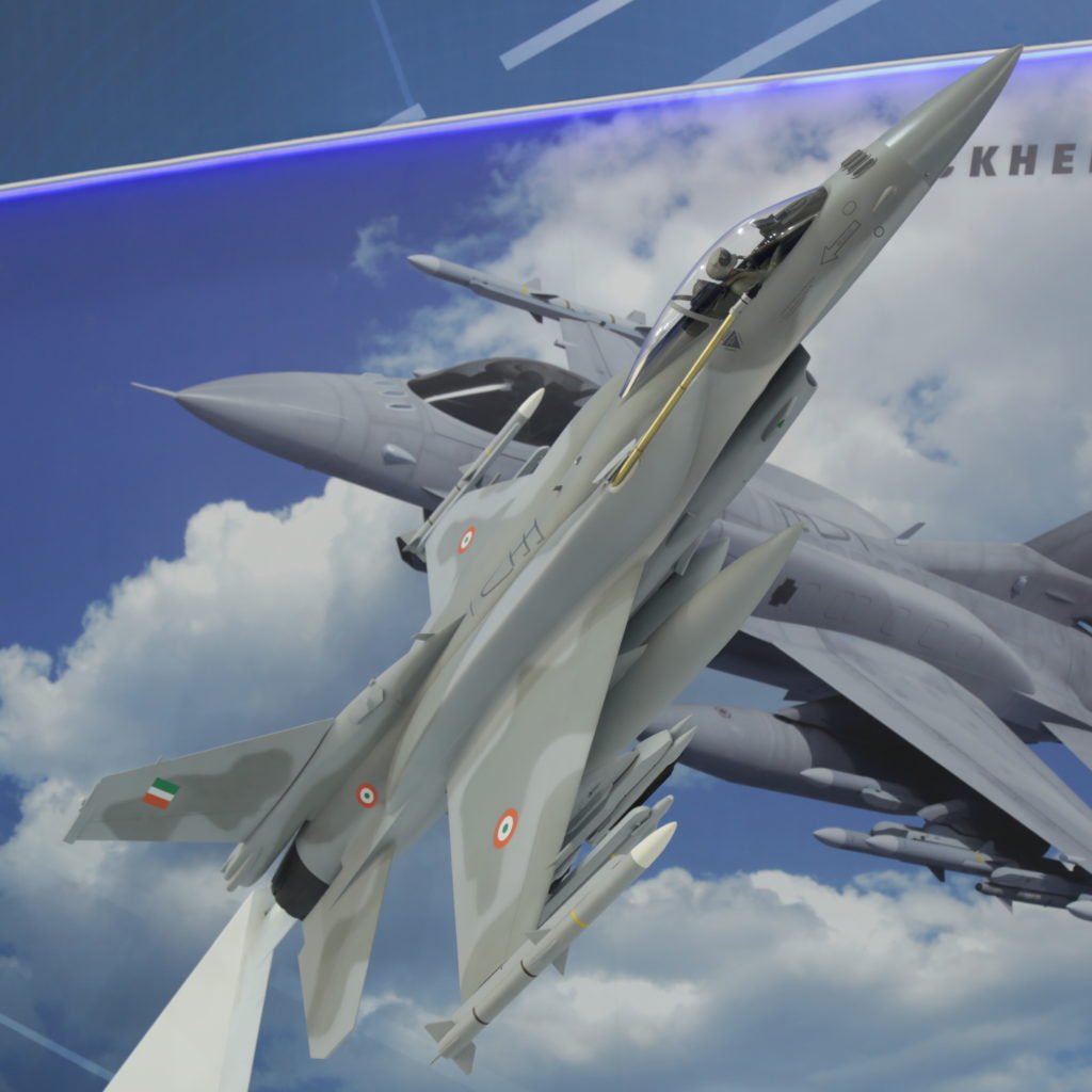

Paint-job
The Block 70 also has a distinctive paint-job called Uniform HAVEGLASS that serves two purposes.
“One of the things they did on the Block 60s — was they did a coating on the Block 60 that’s got the texture of about 40 grit sandpaper — 60 grit sandpaper. It’s very, very rough. It was designed for RCS (Radar Cross Section) reduction. Since then for the Block 70 what we’ve done — from the exterior, if you look at the normal F-16 — most of the world’s F-16s — although they have country-unique paint jobs and in this case we made up an Indian paint-job, one of the thing the United States Air Force — particularly our Air National Guard, has started to implement is this coating called Uniform HAVEGLASS,” said Balserak.
“And the Uniform HAVEGLASS does two things. What Uniform HAVEGLASS does — it is also a radar cross section reducing coating to go on to the outside of the airplane — that’s number one. But the number two reason — and the reason the Guard really likes this is that it’s significantly less maintenance intensive than the old traditional coatings. And that’s why they started to do it. So if you look at — if you go online and look at some of our Air National Guard airplanes a lot of them are starting to put this paint scheme — this Uniform HAVEGLASS on the airplane and this is what we intend to offer India,” he explained.

“So let’s talk about air to ground,” begins Balserak, pointing to a 3D graphic of the aircraft weapons configuration playing on a screen.
“The versatility of the airplane — you see the hardpoints — the physical hardpoints on the airplane — in this configuration what we have here — I wanted to show some versatility — there are literally a thousand combinations you could do but in this circumstance, we have a center-line fuel tank, we have conformal fuel tanks on the top — these are small diameter bombs — 250 pounds a piece — these are laser-guided bombs. These are satellite guided bombs. These are Python 5 air-to-air missiles — and these are AMRAAM 120 missiles,” he listed.
“But the really neat thing about the airplane is that — alright you say ‘Well, this is cool if I don’t have to go very far’, but you can go quite a way even in this configuration. You can remove the weapons in there and hang fuel tanks on — so there are 370 gallon wing tanks, 300 gallon center-line tanks and the Indian Air Force has specifically asked for 600 gallon tanks. So this means I can go a long, long way and stay a long, long time. We have only a few customers that fly with 600 gallon tanks — the United States Air Force does not fly with 600 gallon tanks, to put it in perspective. So that’s air-to-ground,” explained Balserak.
