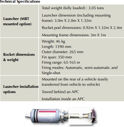

Benefits
- High clearing efficiency
- Operational in all types of terrain
- Operational flexibility: manual semi- and fully-automatic modes
- Fully qualified and operational with the Israel Defense Forces and the French army
- Safe system for the crew

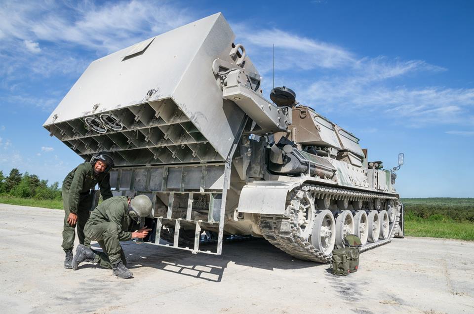

Minefield Clearing and IED Neutralization The Carpet is a modern minefield clearing and IED neutralization system that can clear a path of 100 meters in a minefield with high mine clearance efficiency and can neutralize all types of IED’s The system is operated by two members of the vehicle crew from inside the crew compartment in order to achieve maximum .protection Easily Assembled Launcher The Carpet system consists of a launcher that contains 20 rockets equipped with FAE (Fuel-AirExplosive) warheads. The launcher is an autonomous add-on kit that can be assembled easily and quickly in the field onto any main battle vehicle or suitable military vehicle. The system is self contained, with no hydraulic powe required from the host vehicle. The .system needs only 24V-28V power The Carpet is the most efficient system in the world for minefield /clearing and IED neutralization detonation in any terrain and in all weather conditions, while .maintaining crew safety
-Operational Characteristics
- Main Control Unit (MCU) controls firing and testing from within the cabin
- Cleared path marked with rocket fins
- No prior operation is required
- Takes only one minute to complete the mission
- Quick reloading in battlefield conditions
- Crew practice enabled with training rockets

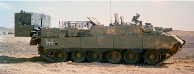

Called 'AMX30 SDPMAC'
