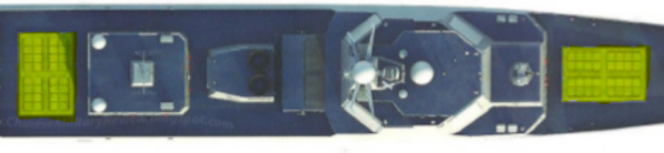

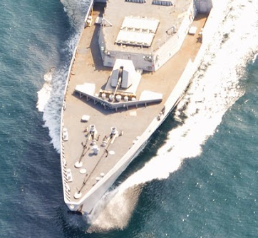

The Kolkata follows the Soviet tradition of having an assortment of weapons at the bow on various raised platforms. It has a 163 m long hull which is retained from its predecessor, Delhi class. It displaces around 6700 tons when fully loaded. The massive size of the ship allows the installation of a wide range of sensors and weapons. The Indians have chosen to leave a lot of deck space for future additions and upgrades.

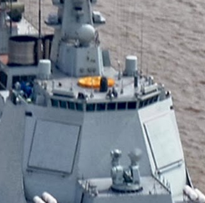

This uses essentially the same hull as its predecessor, the Type-52C. Its hull is slightly smaller at 154 m, but it displaces around 7500 tons when fully loaded suggesting that it is packed to the brim with sensors and weapons and there is hardly any space left for additions of new systems.

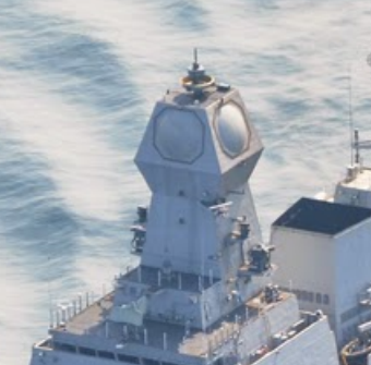

MF-STAR AESA radar
This is the first Indian warship to use an Active Electronically Scanned Array (AESA) radar, which has 4 static panels instead of a single rotating panel. This Multi-Function radar also allows for the replacement of a dozen other smaller search, track and fire control radars with a single system. The Israeli MF-STAR has been chosen for this role. It is mounted very high up on a specially built mast.
The MF-STAR operates in the S-band of radio frequency. It consists of 4 panels mounted on each side of the main mast. This radar is capable of performing a variety of functions like

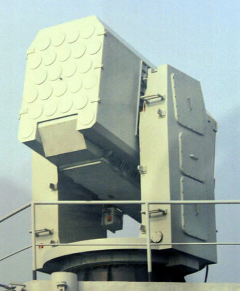

LW-08
Its secondary radar is a Thales LW-08 2D radar which operates in the D-Band. It’s a long range surveillnce radar and provides target indication to weapon control systems.

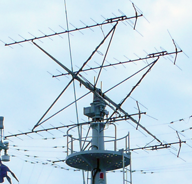

Type 517 radar
The secondary radar on board is the Type-517 A-band VHF air search radar. The biggest problem is that, details of new Chinese radars aren’t available anywhere. But their radars, though powerful, aren’t on par with the western radars.
It scores 8/10 in this category.

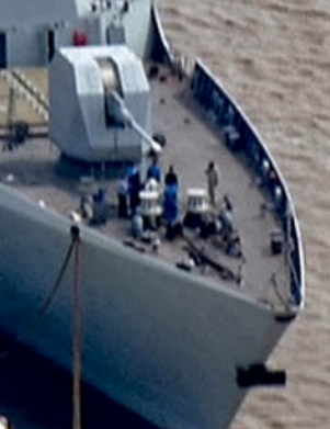

Type 52D:
32 x 2 Vertical Launch Cells
The configuration of this ship for surface warfare can be changed based on mission requirements due to its Universal Vertical Launchers which can fire any type of missile. An ideal layout would consist of 16 YJ-12Anti-Ship Missiles (AShM) for surface warfare. The range of the missile is said to vary from 220 km to around 350-400 km depending on flight profile. The only drawback of this missile over BrahMos is that it travels at subsonic speeds at 40 km altitude and reaches supersonic speeds only during the final dive towards its target, which makes it easy to intercept using long and medium range missiles during the subsonic phase. But an alternate high-low flight profile gives it a range of 250-300 km, putting it in the same category as the Indian BrahMos. Nevertheless, a large number of these missiles can be fired which gives it the ability to saturate modern air defenses.
The flexibility of the UVLS allows it to practically carry 32 AShMs on a dedicated surface warfare mission which is a huge advantage over the fixed 16 AShM loadout on INS Kolkata. This would give it the best AShM loadout among contemporary ships, but a balanced load would be 16 AShMs. The best bet against a salvo of YJ-12 missiles would be a layered air defense system.
Secondary surface warfare capability is provided by a 130 mm main gun. This has an effective range of over 25 km against surface targets and can prove to be very useful in shore bombardment missions. Its capability against aircraft and missiles is very limited. The ability to carry a 16-32 missiles and the presence of a large caliber main gun ensure that it gets 10/10 in this category.

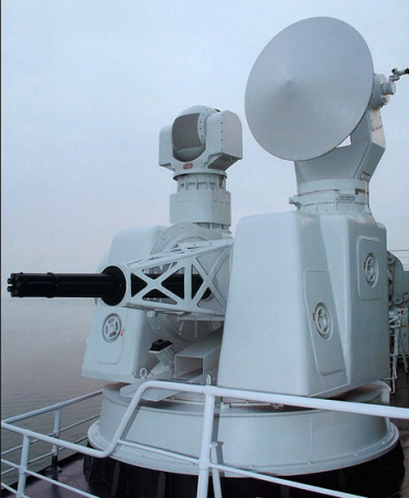

The last ditch anti-missile capability is provided by a Type 730 Close in Weapons system. This has a 6 barreled 30 mm Gatling gun which can effectively engage sea skimming missiles at a range of 2 km. It is a closed loop CIWS and unlike the Ak-630, it has its own radar and electro-optical sensors which reduce its dependency on ship borne sensors and allow it to operate independently. This, combined with the missiles give the Type-52D a 4 layer air defense system, which is definitely an advantage over the 2 layered air defense system of the Kolkata.
It scores an 8/10 in the CIWS category

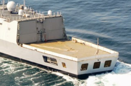

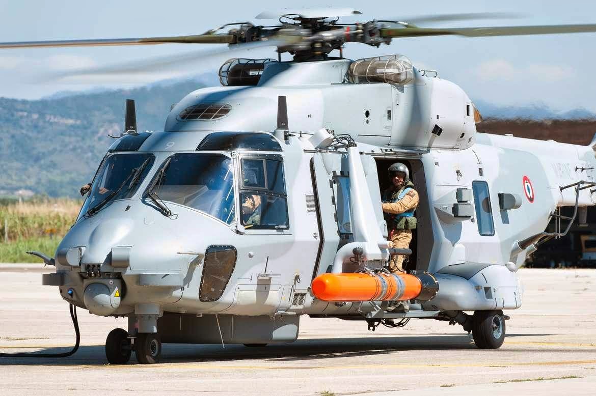

The dual helicopter hangars
Beyond the horizon ASW capability is provided by ASW helicopters. The Kolkata has 2 large hangars which can support any modern ASW helicopter. Since India is most likely to procure MH-60R as its next ASW helo, 2 of those on a destroyer would make it extremely effective against enemy submarines. Currently it can deploy the Seaking ASW helo which can carry 2 lightweight torpedoes. Overall the Kolkata class has a well-balanced and powerful ASW capability on par with its western equivalents.
