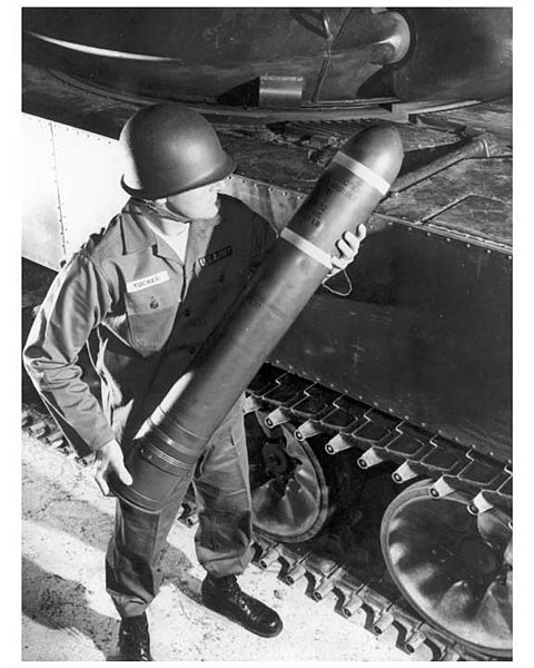

The armament was remarkable as a lightweight solution which could deliver a potentially killer blow. The M81E1 Rifled cannon was a short barrel, able to fire either missiles or tailored ammunitions for fire support. Due to the unfavorable velocity ratio, only traditional HE rounds were fired, for infantry support, while the AP capability was entirely provided by the new Shillelagh missile system. The later was developed in 1958 by Sperry and Ford Aeronautics (Later Martin Marietta) as the XM13, produced in 1964 as the MGM-51. It was 152 mm in diameter with the winglets folded, and 290 mm wingspan unfolded, with a solid-fuel rocket and a 15 pdr shaped-charge (6.8 kgs) warhead. Guided by infra-red signals it could fly at 1,060 feet (320 m) per second. This was sufficient to defeat 150 mm of RHA plate at a 60º angle at the range varying from 2000 to 3000 m depending on the models A, B or C. 88 194 of these were produced until 1971. It was also deployed by the M60A2 “Starship” and the first prototype of the MBT-70. This weapon was completed by a roof-mounted cal.50 M2 (1000 rounds) and a coaxial M73 LMG with 3000 rounds.

Production started on 29 July 1966, and the Sheridan entered service in June 1967. In all 1,662 M551s were built between 1966 and November 2, 1970, for a total cost of $1.3 billion for the entire program. However, problems with the M81 gun quickly showed, as cracks developed near the breech after intensive firing, later linked to the Shillelagh “key” running in a slot cut into the barrel. The modified M81E1 introduced a shallower slot and matching modification to the missile. Still, the gun was criticized for having too much recoil for the vehicle weight and frail construction. The blast was enough to lift-off the second and even third road wheels. Experimental 76 mm guns were also tried but never adopted.

152mm shillehag round
