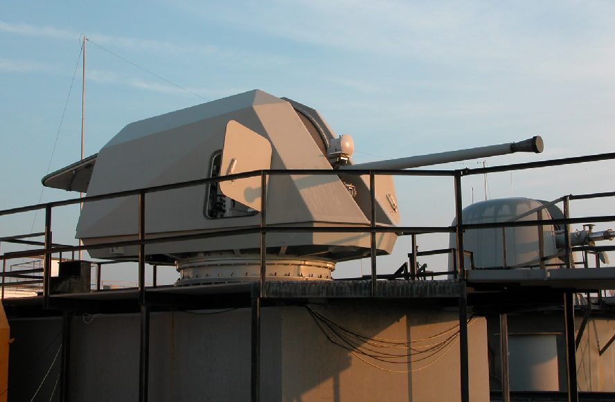

76/62 Super Rapid Multi Feeding (SRMF)

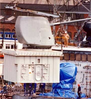

The 76/62 Super Rapid (SR) Gun Mount is a light weight, rapid-fire naval gun providing unrivalled performance and flexibility in any air defence and anti surface role, particularly in anti-missile role.
Capability for very effective engagement of shore based targets is also provided for unique multi-role performance.
The 76/62 SR is suitable for installation on ships of any type and class, including small naval units.
Interface to a large variety of ship's Combat Management System and/or FCS/EOS is provided, according to digital as well as analogical standard, including open architecture.
The Firing rate can be selected from single shot to firing 120 rds/min.
In operational condition the tactical time is less than 3 seconds and the standard deviation at firing is less than 0.3 mrad, thus providing excellent accuracy.
The 76/62 SR (together with the 76/62 Compact) is the only medium caliber naval gun available in the capable of sustained fire, which is a fundamental requirement in any scenario involving the simultaneous engagement of multiple maneuvering target, as requested by the emerging asymmetric warfare scenarios.

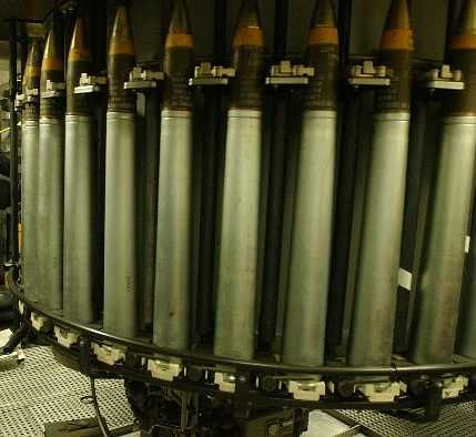

Automatic loading is provided through a revolving magazine and rapid reloading is easily undertaken even during firing action by two ammunition handlers.
Standard supply includes the new Digital Control Console (DCC) capitalizing the digital technology to increase the functions available to the operator and to the maintainers.
The 76/62 SR is ready for operating the OTO Melara 3AP Multifunction Programmable Fuse.
The in service and new 76/62 SR, have the necessary flexibility for being fitted with optional:
  • Integral Stealth Shield to reduce the total RCS of the ship
  • Muzzle Velocity Radar to update the FCS of eventual deviations from range table values
  • Multi Feeding Device for the automatic handling, selection and feeding of any type of ammunition loaded

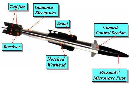

  • STRALES system – a guidance system for the DART guided projectile.

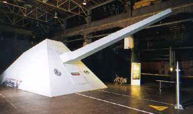

AGS Mockup showing the originally planned triangular barrel
Note the bicycles for scale and the ERGM-style projectile on the far right
AGS Mockup

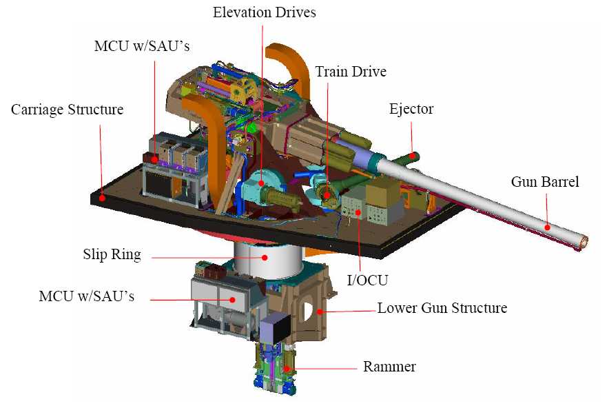

AGS Components
MCU = Microcontroller Unit, SAU = Subscriber Access Unit, I/OCU = Input/Output Control Unit

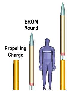

Size comparison of projectiles and propellant canisters

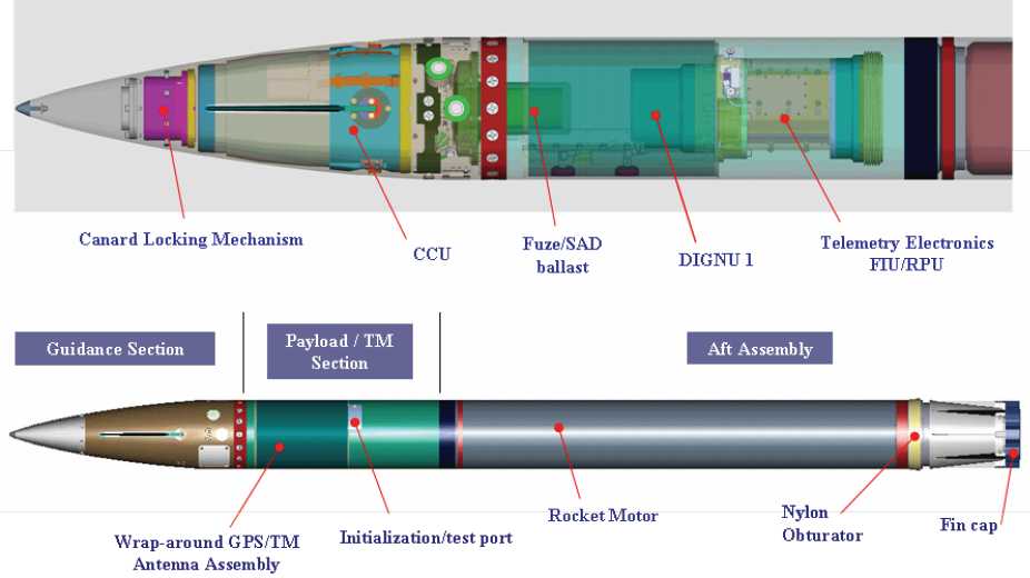

Details of LRLAP
CCU = Canard Control Unit, GPS/TM = Global Positioning System/Timing Module, SAD = Safety and Arming Device, DIGNU = Deeply Integrated Guidance and Navigation Unit, FIU/RPU = Fuze (?) Interface Unit/Remote Processing Unit

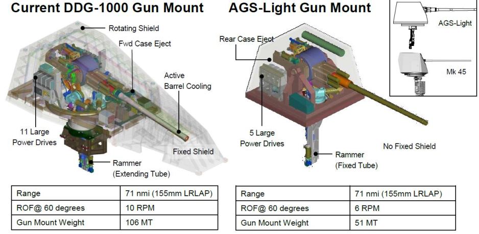

Comparison of AGS with AGS-L
Note that the AGS has Active Barrel cooling while the AGS-L does not
Image copyrighted by BAE Systems

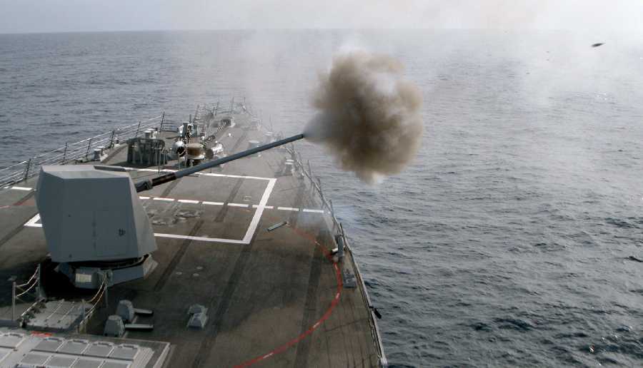

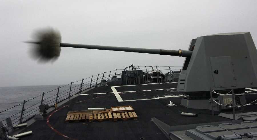

5"/62 (12.7 cm) Mark 45 Mod 4

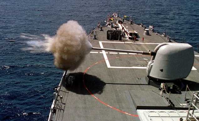

USS Preble DDG-88 during firing trials in February 2003
Note the projectile at the upper right and the ejected shell casing
US Navy photograph No. 030218-N-8029P-001

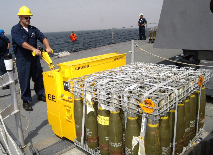

Re-ammunitioning USS Lassen DDG-82 in September 2007
Note the powered dolly. Not your father's way of moving projectiles around on a warship!

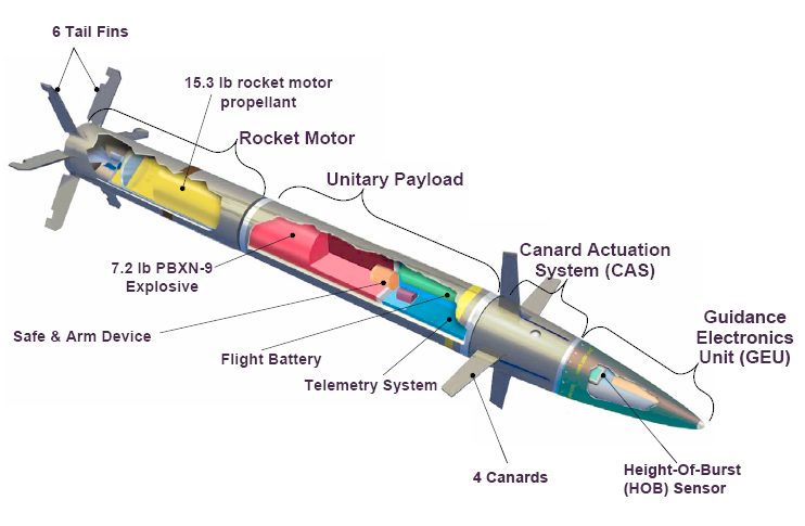

ANSR Rounds
Picture copyrighted by Alliant Techsystems

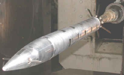

ANSR during Wind Tunnel Test at LVT
Note the forward canard and base airfoils
Picture courtesy of Naval Surface Warfare Center

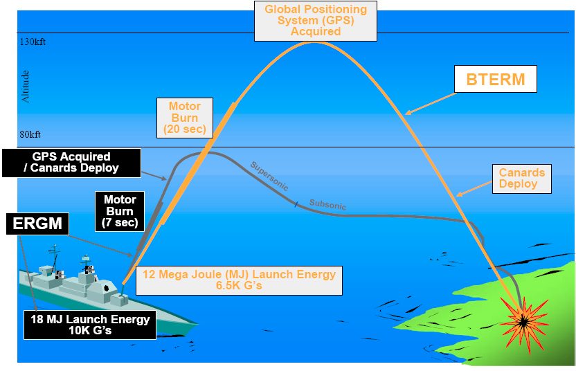

Flight Profiles of ERGM and BTERM
Sketch courtesy of NAVSEA Naval Gunnery Project Office

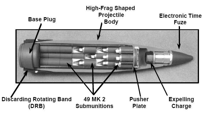

Mark 172 HE-ICM

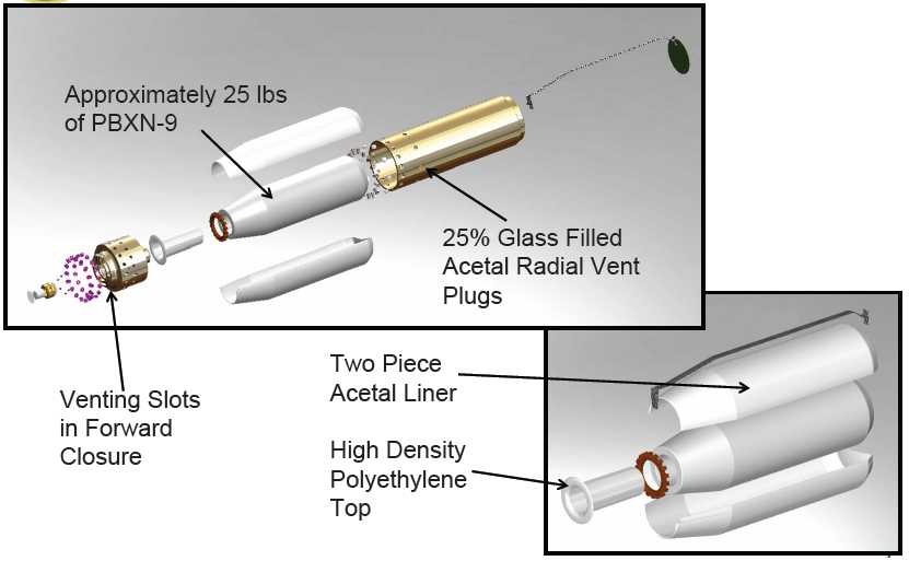

Cutaway of EX-175 Propelling Charge
Cutaway of EX-167 Propelling Charge​

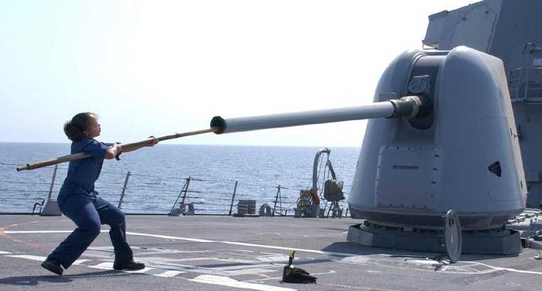

Barrel cleaning on USS Hopper DDG-70
US Navy Photograph No. 020805-N-3580W-005

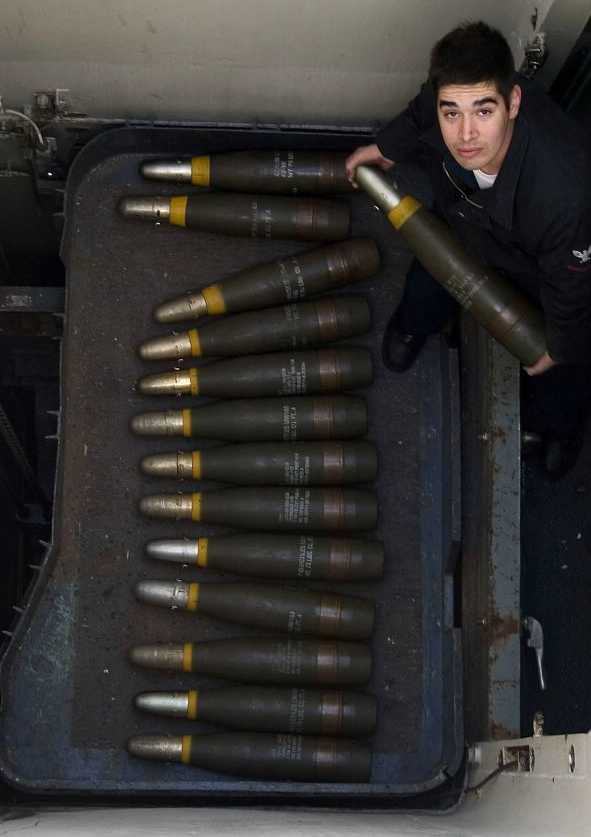

Gunner's Mate 3rd Class Arthur Bilbey stacking ammunition on USS Curtis Wilbur DDG-54 in January 2005
U.S. Navy Photograph No. 050111-N-9851B-010

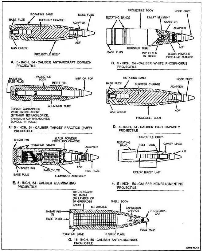

Ammunition types used on the 5"/54 (12.7 cm) and one for the 16"/50 (40.6 cm) Mark 7
Sketch of Mark 64 Projectile

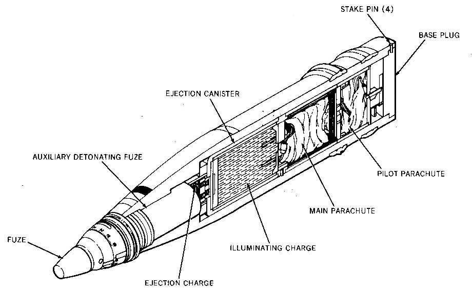

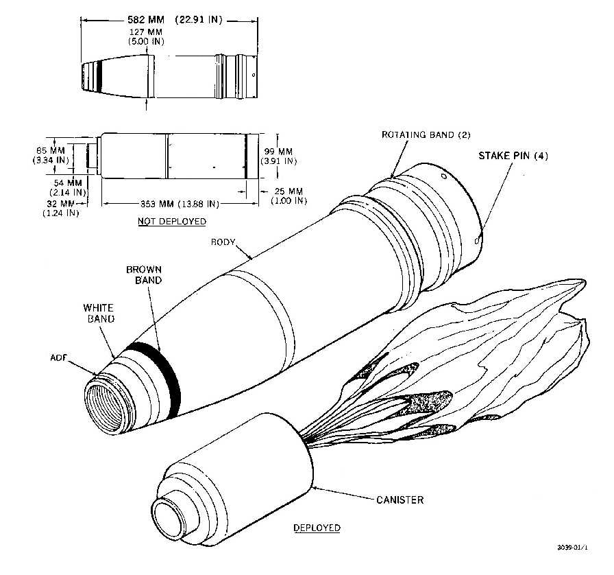

Cutaway view of Mark 88 Illumination Projectile
Components of Mark 88 Illumination Projectile​

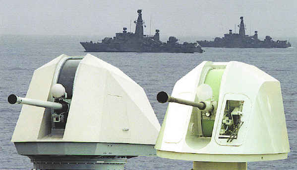

MM Audace
Two 76 mm (3") Compact guns are along the starboard side
Official Marina Militare Italiana (Italian Navy) photograph

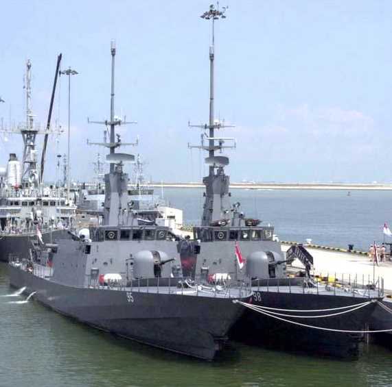

Compact guns on Singapore Patrol Boats Brave (95) and Daring (98) in June 2001
The "radar mast" on Daring (98) is actually a light pole on the dock behind her
Detail from US Navy Photograph No. 010613-J-9271Z-008

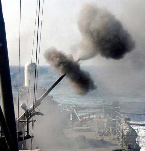

76 mm (3") gun on an Australian Adelaide Class Frigate

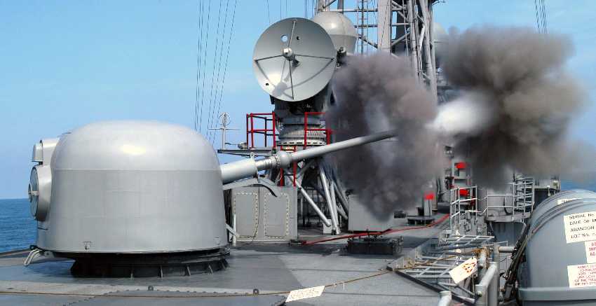

The unique double plume of smoke forms as a result of the muzzle brake redirecting some of the propellant gasses back towards the gun
Australian Navy Photograph No. FFG01-8098687-030605-008

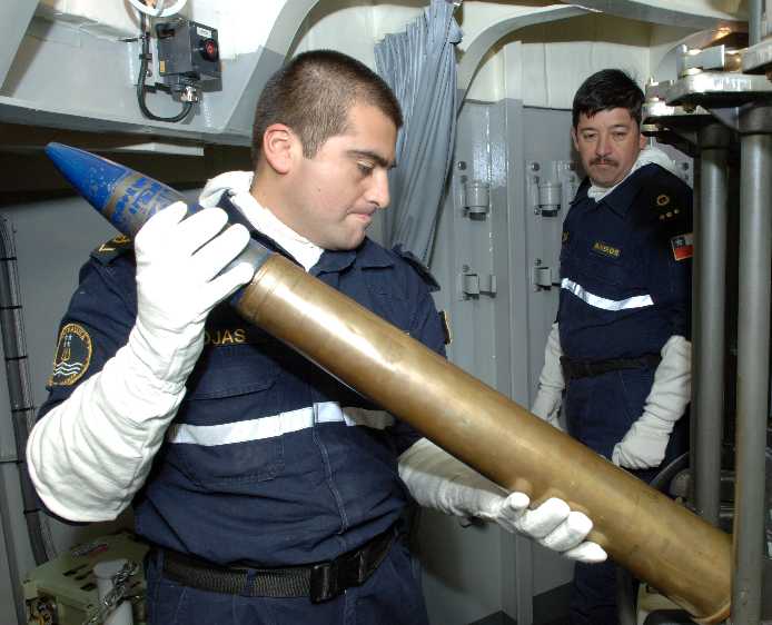

Loading a practice round aboard Chilean Navy frigate CS Riveros (FF18) in July 2008
US Navy Photograph No. 080720-N-3931M-078

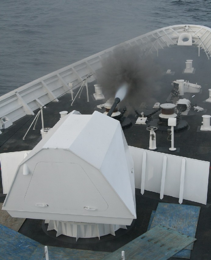

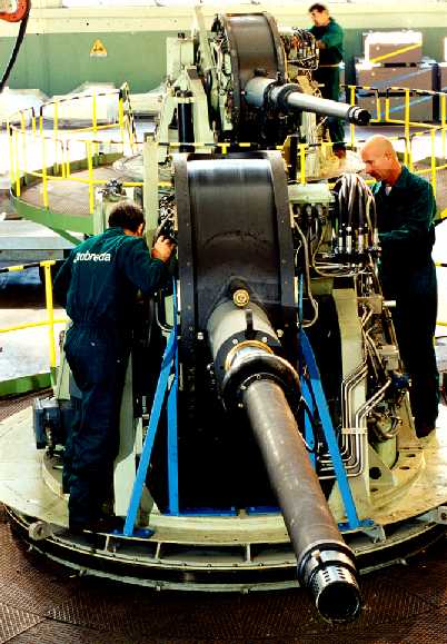

76 mm (3") guns being built at the OTO-Melara Facility
Photograph copyrighted by Finmeccanica

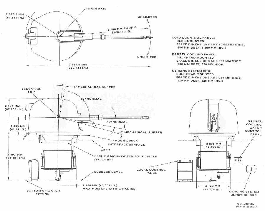

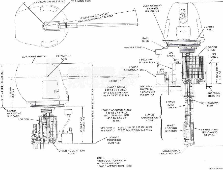

USN 76 mm (3") Mark 75 Sketch from General Specification Sheet
Sketch copyrighted by United Defense

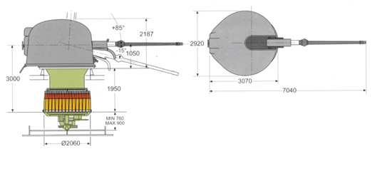

Sketch of SR Mounting
Note that the overall length is slightly shorter than in the Compact mounting
Image copyrighted by OTO-Melara

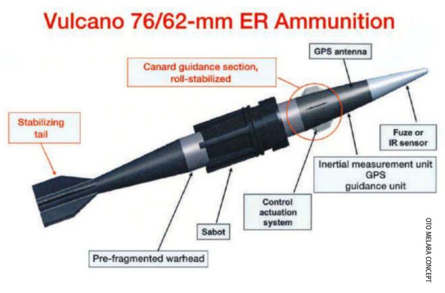

Vulcano 76 mm projectile
This is the proposed guided version, the initial projectile will be unguided. See 127 mm/64 Datapage for other details.​

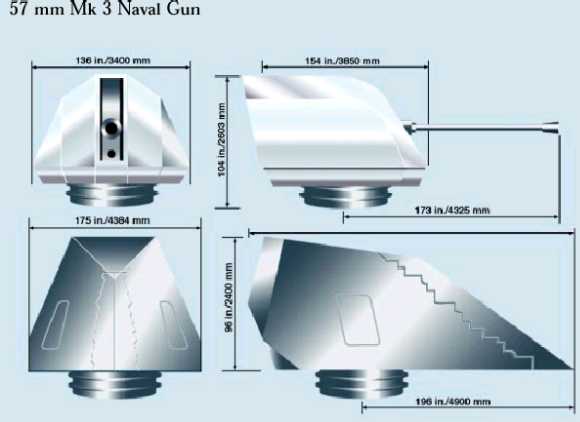

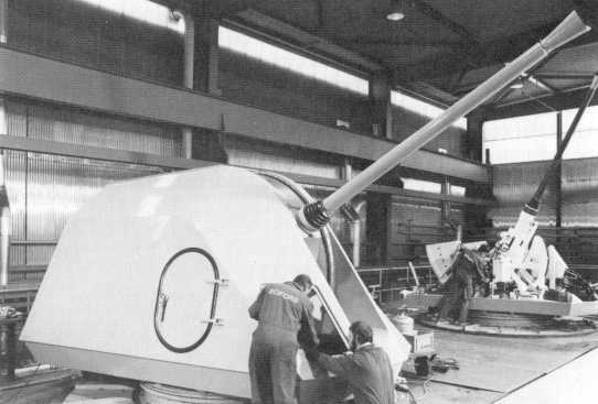

57 mm/70 Bofors Mark 3

57 mm Mark 3 showing standard and low radar cross-section (LRCS) mountings
This LRCS mounting was not adopted, see below for LRCS for DD(X)

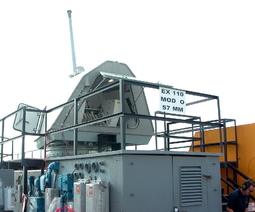

57 mm/70 Bofors Mark 3 (EX 110) with all access hatches opened
Taken at Naval Surface Warfare Center Dahlgren (NSWCD) in November 2003
Note the 76 mm/62 Mark 75 at the right
USCG Photograph
57 mm EX (for Experimental) Mark 110 mounting with gun barrel in the reload position
During reloading, the gun barrel is raised to its maximum elevation, which lowers the ready use magazines. The ammunition cassettes are then traversed over the tops of the ready-use magazines and empty their rounds into them.
In this photograph, the right-hand ammunition cassette is the curved box inside of the housing. The tops of the ready-use magazines can be seen to the left of this cassette. Note the triangular shape of the openings in the ready-use magazines, which guide the noses of the projectiles as they drop into the ready-use magazines.

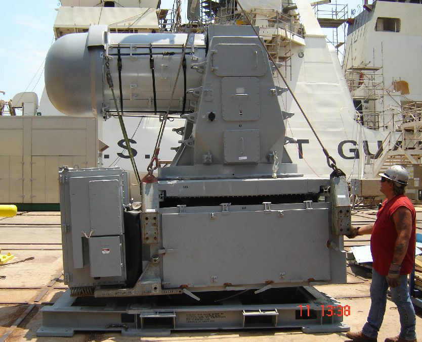

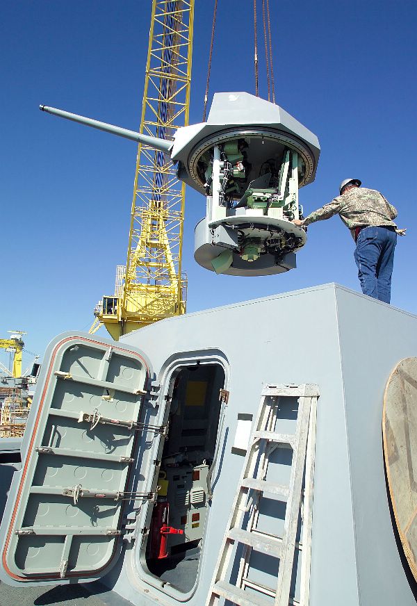

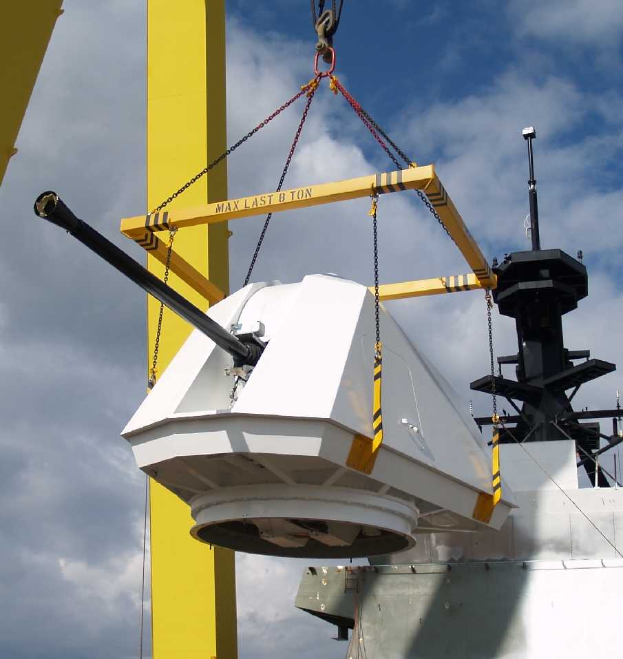

57 mm being installed onto USCG Bertholf (WMSL 750) at Northrop Grumman Ship Systems in Pascagoula, Mississippi

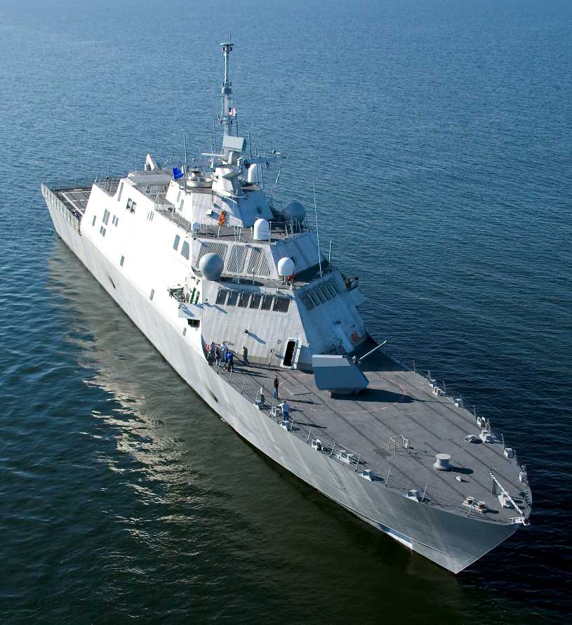

USS Freedom LCS-1 preparing for trials on 28 July 2008
Lockheed-Martin Photograph released as US Navy Photograph No. 080728-O-XXXXX-008

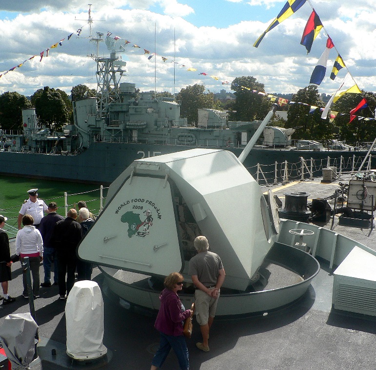

57 mm Mark 3 on HMCS Ville de Quebec
In the background is HMCS Haida
Photograph copyrighted by Mike Clark and used here by his kind permission

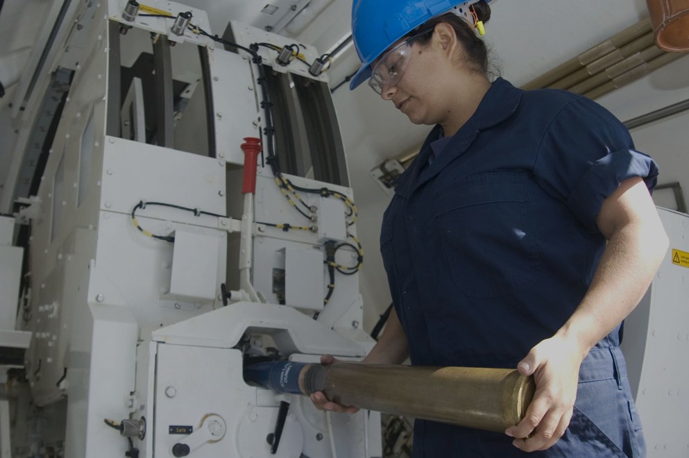

Test round being loaded into the breech on USCG Bertholf (WMSL 750)
Note the roomy gunhouse of this mounting and the twin ready use magazines directly above the breech
USCG Photograph titled "57mm"

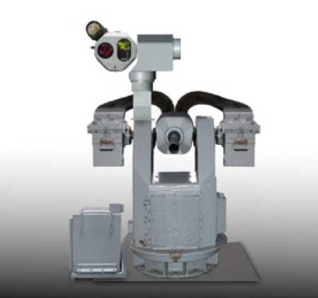

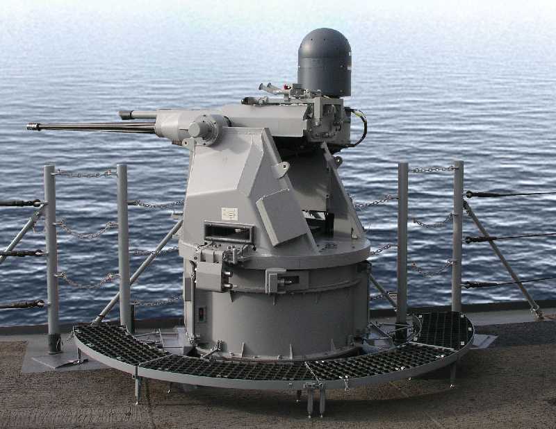

30 mm (1.2") Bushmaster II Mark 46 Mod 1​
40 mm (1.57") Bushmaster II​

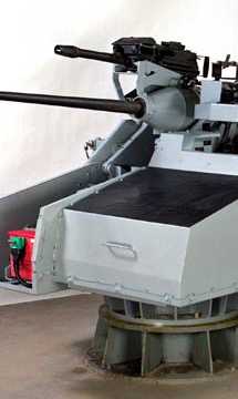

The 30 mm Bushmaster II is derived from the proven 25 mm M242 Bushmaster automatic weapon. This next-generation member of the Chain Gun®family applies the same design simplicity, positive round control, ease of maintenance and constant velocity ammunition feed of the battle-proven Bushmaster cannon. The Mark 46 system is a navalized version of the gun used on the Advanced Amphibious Assault Vehicle (AAAV) and on the San Antonio LPD-17 class.
The larger 30 mm Bushmaster II incorporates 70 percent of the logistic parts used in the 25 mm M242 Bushmaster, offering operators low-risk, proven performance and NATO common parts supply. The production barrel will be chrome plated for extended life.
The mounting for this weapon will be shared with the Expeditionary Fighting Vehicle (EFV) - formerly known as the Advanced Attack Amphibious Vehicle (AAAV) - being built for the US Marine Corps.

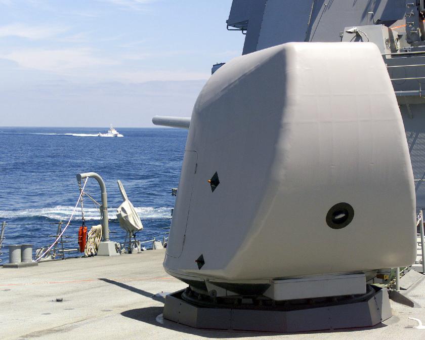

From the LPD-17 website: "The Mk 46 30 mm gun system is a two-axis stabilized chain gun that can fire up to 250-rounds per minute. The system uses a forward looking infrared sensor, a low light television camera, and laser range finder with a closed-loop tracking system to optimize accuracy against small, high-speed surface targets. It can be operated locally at the gun's weapon station (turret) or fired remotely by a gunner in the ship's Combat Information Center."
This weapon can be converted to fire 40 mm rounds with a change of barrels and minor changes to the feeder assembly. This conversion can be performed by the ship's crew.
A 15 September 2005 Alliant Techsystems (ATK) Press Release announced that ATK "will provide its proven 30/40mm Mk44 Bushmaster Cannon system to MSI Defence Systems for integration onto its DS30M Mk2 Naval Mounting. The UK Royal Navy (RN) has ordered a total of 26 systems for the new Type 23 Frigate, with deliveries scheduled to begin in late 2006. This is the first time ATK will provide the Bushmaster for use on a RN vessel and it extends the Bushmaster’s reach beyond armored vehicle applications to shipboard use."

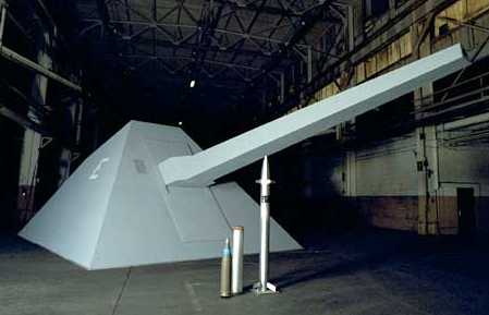

These 30 mm weapons replaced the 57 mm Bofors guns planned for the USS Zumwalt DDG-1000 class.
Bushmaster II
Photograph copyrighted by Alliant Techsystems
Installing a Mark 46 Mod 1 weapon system onboard USS San Antonio (LPD-17) in November 2005

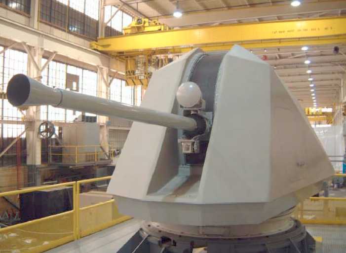

This same mounting is used on USS Freedom LCS-1 and planned for the USS Zumwalt DDG-1000 class
US Navy photograph 051026-0-0000B-001

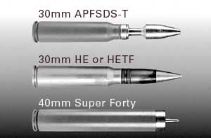

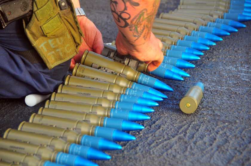

Ammunition for the Bushmaster II
Note that the 40 mm round is the same overall length as the 30 mm rounds, thus simplifying the changeover to the larger caliber

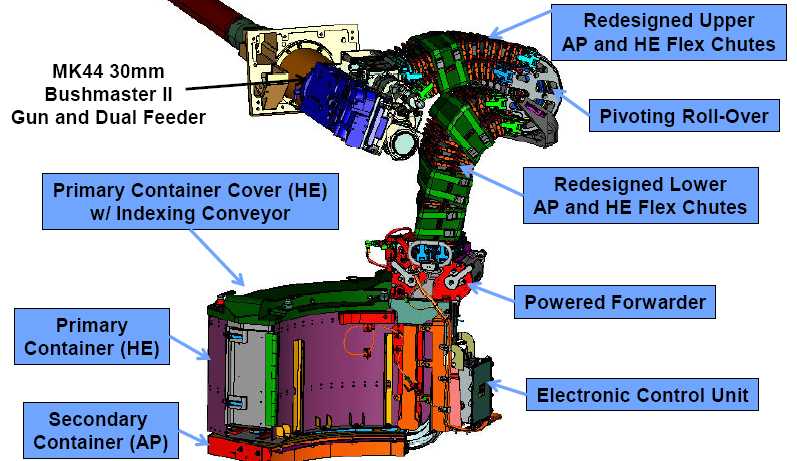

30 mm ammunition feed system for Mark 46 Mounting on USS Freedom LCS-1
US Navy photograph 130924-N-PD773-005

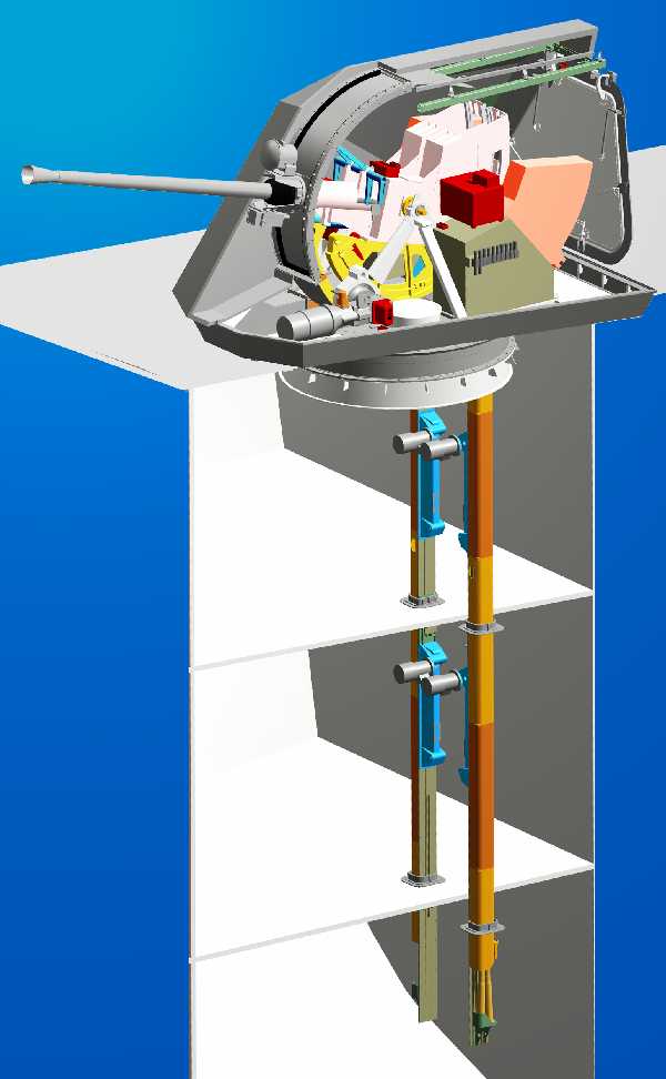

Cutaway view of Mark 46 Mounting showing dual-ammunition feed system
Image copyrighted by General Dynamics ATP​

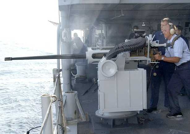

Constable 1st Degree Thomas Pedersen of the Danish Navy corvette Niels Juel (F 354) fires a 25 mm Mark 38 MGS aboard USS Anzio CG-68 in June 2002
U.S. Navy Photograph No. 020612-N-0872M-502

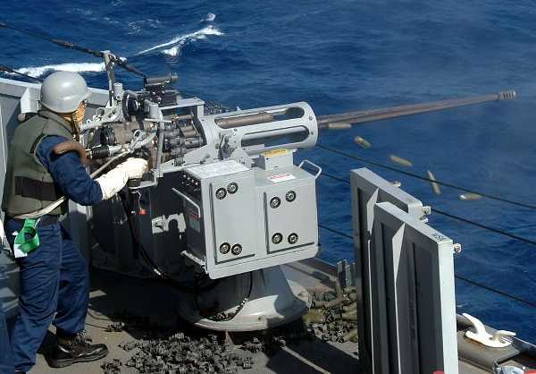

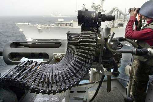

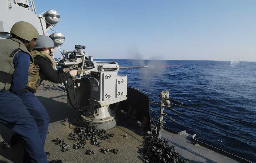

25 mm Mark 38 gun crew firing at a "killer tomato" aboard USS Curtis Wilbur DDG-54 in January 2006
Note the large piles of links
U.S. Navy Photograph No. 060112-N-2385R-194
Remotely Controlled and Stabilized 25 mm Mark 38 Mod 2
Photograph copyrighted by United Defense

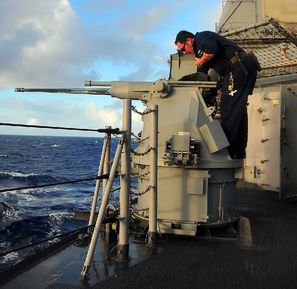

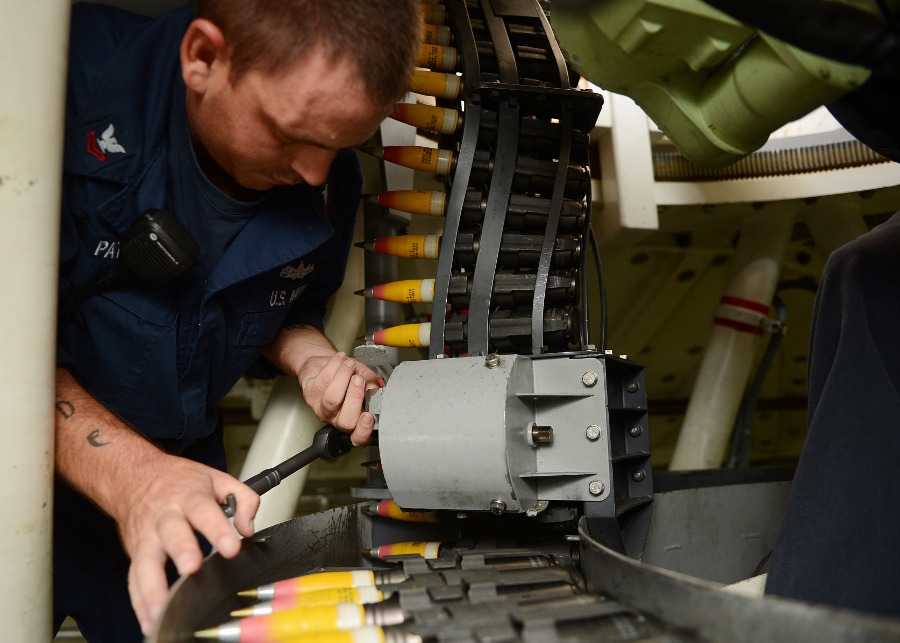

Performing maintenance to a 25 mm Mark 38 Mod 2 gun system aboard USS Lake Champlain CG-57 in January 2009
The tube above the gun barrel is the spent cartridge ejecter port
U.S. Navy Photograph No. 090129-N-4774B-007

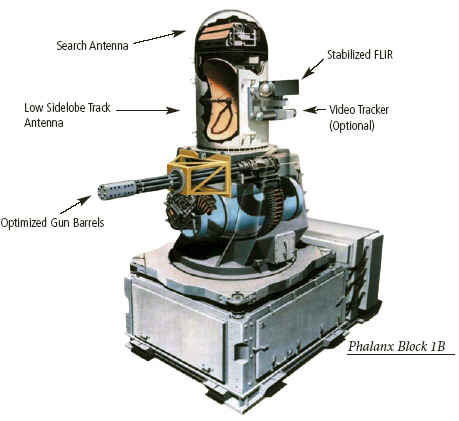

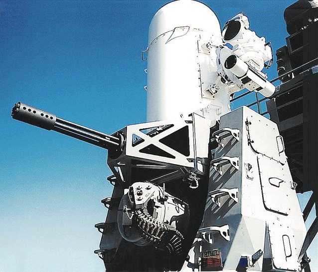

20 mm/76 Phalanx Mark 15
Close-in Weapon System (CIWS)​

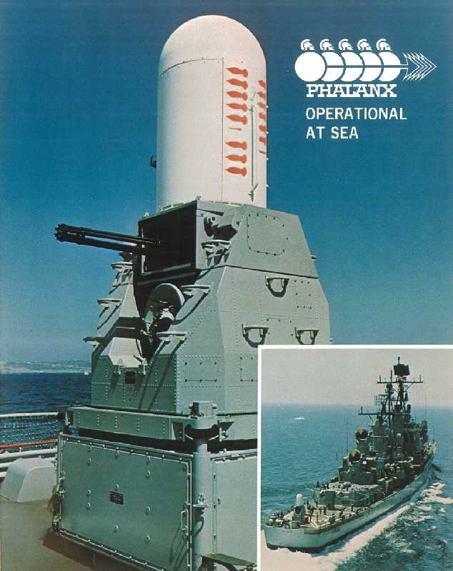

Close-in Weapon Systems (CIWS - usually pronounced "see-whiz") are designed to engage anti-ship cruise missiles and fixed-wing aircraft at short range. Phalanx is the most numerous CIWS in the world and has been exported to many other countries. Like other close-in weapon systems, Phalanx provides ships with a terminal defense against anti-ship missiles that have penetrated other fleet defenses.
Phalanx is very much a self contained system requiring minimal deck space and wiring. Unlike many other CIWS, which have separate, independent systems, Phalanx combines search, detection, threat evaluation, acquisition, track, firing, target destruction, kill assessment and cease fire into a single mounting.
First operational Phalanx Mounting aboard USS King DLG-10 (later DDG-41)
Photograph courtesy of Dan Lamkin of NAVSEA and Mark Donovan, Ship Historian, USS King Association
Phalanx Block 1B
US Navy Photograph

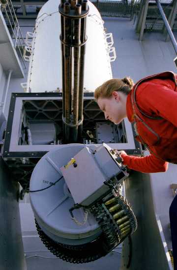

Reloading a CIWS aboard USS Theodore Roosevelt CVN-71 in May 1998
US Navy Photograph No. 990528-N-2003S-002-TR212

Lifting a Phalanx CIWS onto USCG Bertholf (WMSL 750) at Northrop Grumman Ship Systems in Pascagoula, Mississippi
USCG Photograph

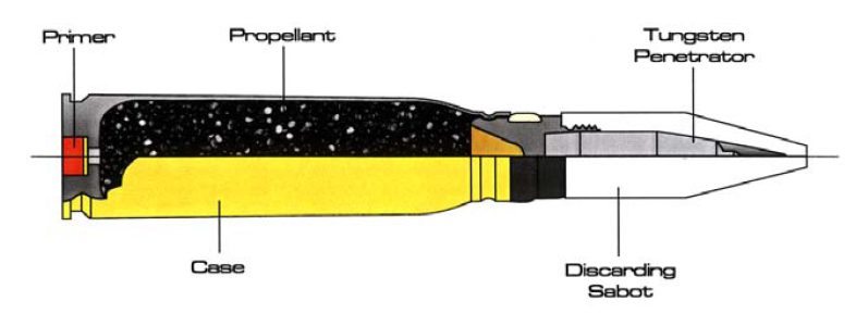

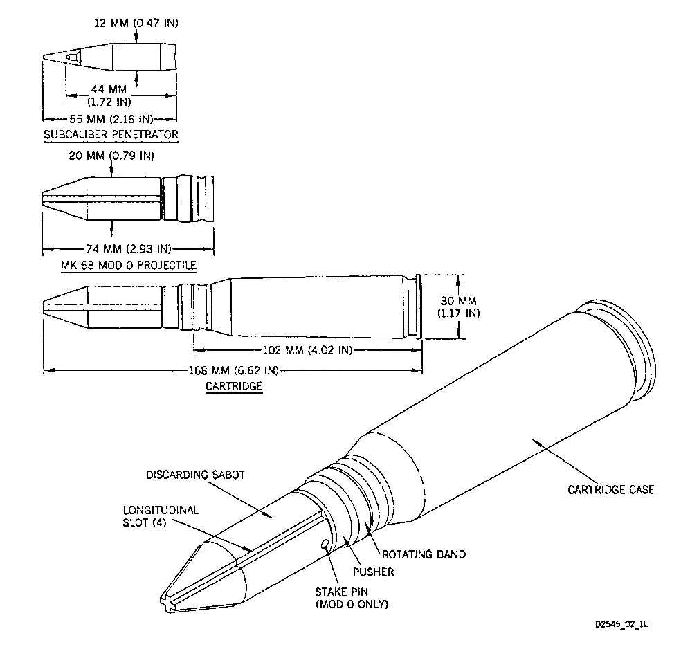

Cross-section of Mark 149 APDS Round
Sketch copyrighted by General Dynamics Company
Dimensional Sketch of Mark 149 Round

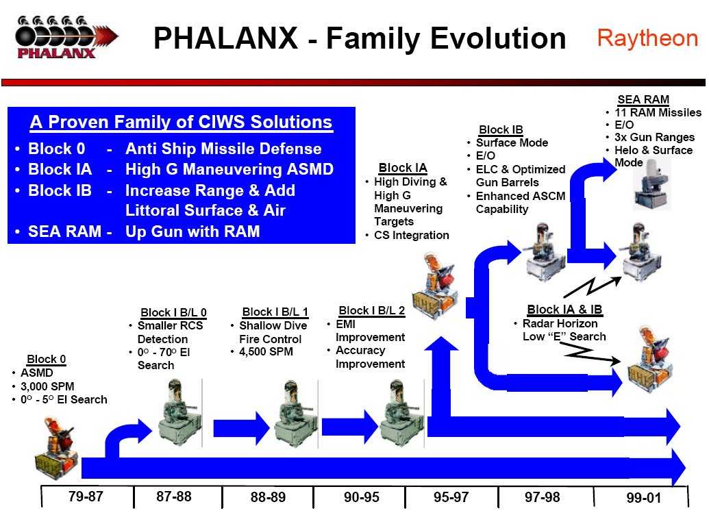

Evolution of Phalanx Systems
Sketch copyrighted by Raytheon

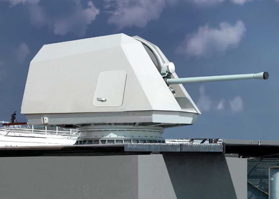

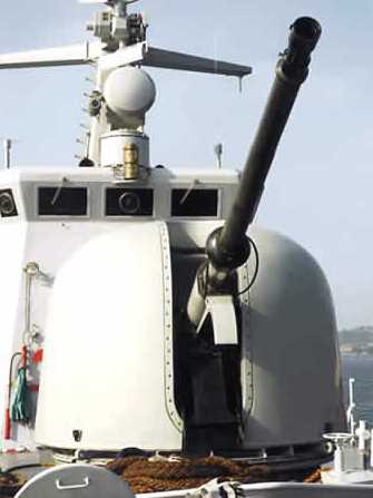

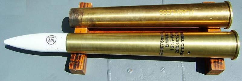

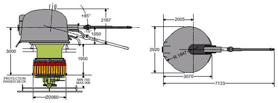

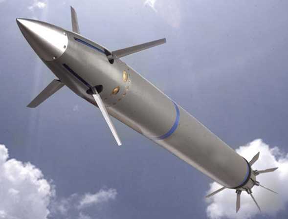

OTO Melara 76/62 Super Rapid Naval Gun
The 76/62 Super Rapid (SR) Gun Mount is a light weight, rapid-fire naval gun providing unrivaled performance and flexibility in any air defence and anti surface role, particularly in anti-missile role.
The 76/62 SR (together with the 76/62 Compact) is the only medium caliber naval gun available in the capable of sustained fire, which is a fundamental requirement in any scenario involving the simultaneous engagement of multiple manoeuvring target, as requested by the emerging asymmetric warfare scenarios.
The 76/62 SR is ready for operating the 3AP Multifunction Programmable Fuse.
