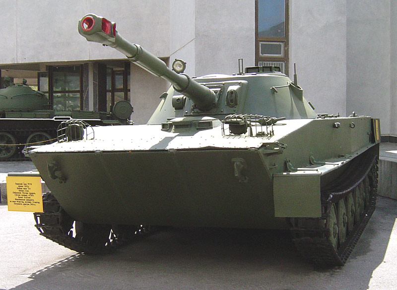

The PT-76 (named after its main gun) was the first new postwar Soviet light tank. There was a tradition of building light amphibious tanks dating back with the local adaptation of the Vickers amphibious 1929 vehicle and the prewar T-37A, T-38 and wartime T-40, all mass-produced. But these vehicles were quite slow in water and improvements were needed. At Leningrad ChTz factory complex (Chelyabinsk) VNII-100 institute the “Obyekt 740” designed by the engineer N. Shashmurin was presented in 1949. It was originally co-designed with Zh. Kotin from the Kirov Plant and the first tests proved successful. It had good overall performances and an innovative water-jet design system. This was followed by a final prototype built at Kirov Plant in 1950, and after a second campaign, the vehicle was adopted on August 6, 1951, as the PT-76. It was known in Russian as the Плавающий Танк, Plavayushchiy Tank (literally “floating tank”).
Design of the PT-76
The PT-76 design was straightforward, as a stretched out T-40. The driver was at the front, fighting compartment in the middle and engine at the back. The commander was stationed at the left and loader at the right-hand side of the main gun. The former fired the gun and acted as a radio, thus reducing his observation capabilities. The turret top was fitted with a large oval shaped double hatch. The driver sat in the front center, had one piece hatch, three vision blocks and periscopes located on the top of the glacis slope beneath the main gun. Below him was located an emergency escape hatch. The main driver’s periscope was equipped with the TVN-28 night vision which gave him a good view at 60m.
The turret was of truncated cone type, with a hand-rotatable commander cupola on the left side of the main double hatch. The latter could be open frontally (acting as a shield) or backward. It had three TPKU-2B vision blocks and two TNP day periscopes. At his disposal, there was also a 4X optical sight coupled to the main gun, and a TShK-66 sight/rangefinder. The loader had an MK-4 observation device in the main hatch.
The hull was made of cold rolled welded steel, completely sealed. Turret armor was 20 mm at 35° on the front, 16 mm on the sides, 11 mm rear and 8 mm top. The hull armor was 10/13 mm at 80° on the frontal glacis sloped beak, 14 mm sides, 7 mm rear and 5 mm bottom, only effective against small arms fire. Equipment included an intercom, gyro compass, 10-RT-26E radio with extensible antenna, two headlights on the hull’s front and a turret’s searchlight on the right-hand. The lack of NBC was problematic compared to other Soviet vehicles but was palliated by the PT-76B.
The main 6-cylinder, 4-stroke water-cooled engine was a straight in-line diesel obtained by halving the standard V12 of the T-54/55 series. It developed 240 hp (179 kW) at 1,800 rpm, with a cooling system and an initial heater. Cross-country capabilities were average (the hull ad to be raised later in production), but it could climb a 52° gradient cross a 1.1 m high vertical obstacle and 2.8 m wide trenches. Its 5-speed manual shaft-type (5 fwd/1 reverse) transmission was derived from the T34/85. Steering was completed by side clutch enables sharp turns and a handbrake.
The engine was fed by a regular fuel tank but four additional ones (two flat and two drum types) could be mounted at the rear, above and on the rear plate. The wheeltrain comprised six evenly spaced rubberized large road wheels mated on single torsion arms, drive sprocket at the rear and idler at the front, with no return rollers.
In amphibious mode, the engine thrust could be directed in two water-jets at the rear, after switching on the two electric bilge pumps, and raised the trim vane which was usually stored inside in the bow but could serve as an additional armor. Combined with the high-angle prow shape, it was able to swim like a fast landing craft. Additional inlet-type water-jet inlets were located over the last roadwheels at the rear of the hull, allowing better directional control in the water, or even reverse course, in combinations with the main jets. A great improvement over previous models using shafts and rudders, designed by N. Konowalow, also adopted later by the BTR-50. However buoyancy needed a large, light surface and subsequently, the PT-76 was unusually large for a light tank, especially with such protection.
The main armament, revised during production, was the standard rifled D5T 76.2 mm tank gun. Of 42 calibers, it had a practical 1500 m range and a rate of fire of 6-8 rounds per minute. It had a depression of -4 and +30 degrees and could fire when swimming. 40 rounds were in store, comprising a mix of OF-350 Frag-HE, AP-T and BK-350M HEAT. The latter could have the better characteristics and can pierce through 280 mm of armor at 1000 m, with a 650 m optimal range. The early models had no gun stabilization system at all, while the two later versions had a 1-axis, then 2-axis on the PT-76B. The coaxial 7.62 mm SGMT had a 1000 m practical range, reduced to 500 in daylight on the move and less than 600 by night. It fired by short bursts, at 250 rounds per minute and was fed by 1000 rounds, including tracers. By 1967 it was replaced by the PKT.
