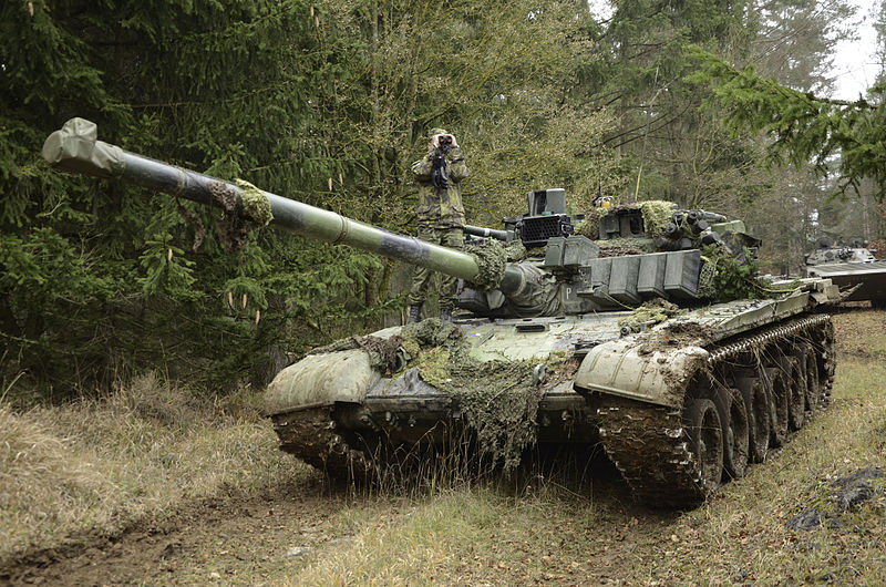

Czech T-72M4 CZ
Local production version derived from the rejected M3, with a custom design gunner and commander thermal image sights. The gunner’s one is a two part doors sight and the commander’s is a tall cylindrical one (as for the Leclerc MBT).
It has additional ERA protection and improved turret armor, MB smoke grenade dischargers, Galileo Avionica TURMS-T computerized FCS, Perkins CV12-1000 740 kW/1,000 hp diesel engine coupled with an Allison XTG-411-6 automatic transmission and completely reworked NIMDA suspension. 30 were upgraded recently this way.

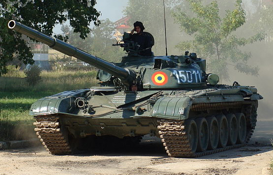

Romanian TR-125
The Romanian-built version of the T-72 with extra armor, modified suspension and a more powerful diesel engine.

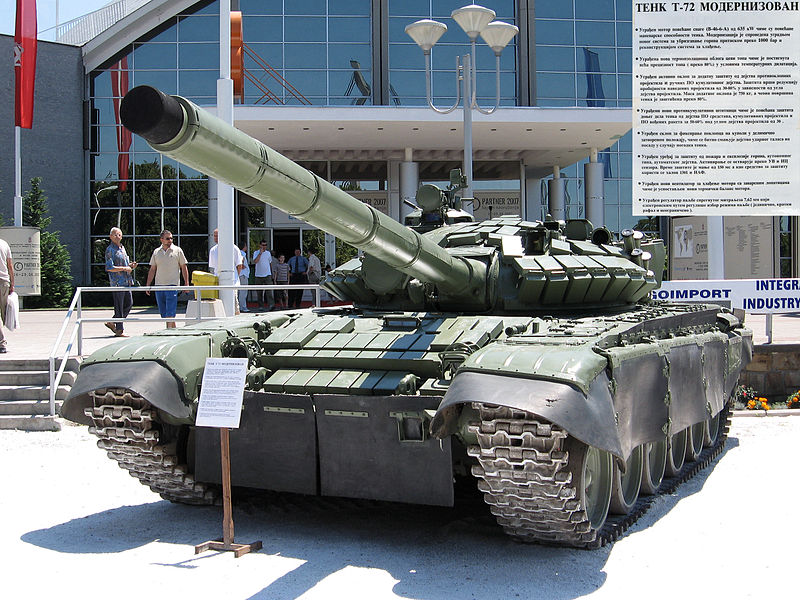

Serbian M-84AS
The T-72 local vesion upgraded to the T-90 standard Yugoimport SDPR which also produce an export modernization package. The M-84AI is the ARV variant.

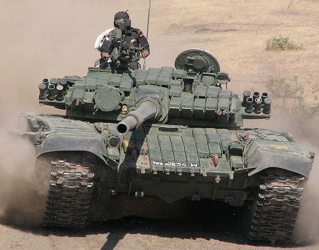

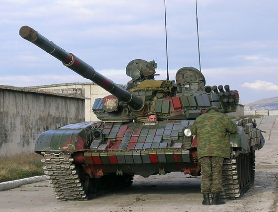

T-72BA
The ERA version fitted with 227 “Kontakt-1” reactive armor blocks on the turret front and mid-sides, glacis, and with sideskirts.

Czech T-72M4 CZ

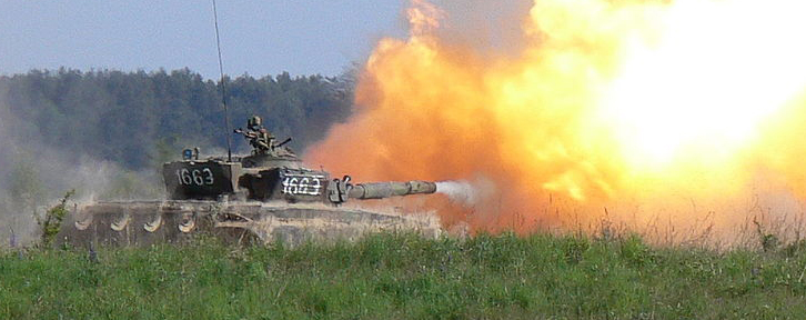

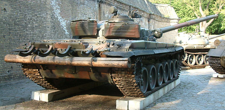

Polish versions
Poland was the second-largest producer of T-72s outside USSR. Notably the T-72M/M1 (“Monkey”) for export and the late version “Wilk” and “Twardy”.
The Polish T-72M/M1
Built by “Bumar-Łabędy” plant in Gwilice. Fitted with the initial “Gill armour”, then rubber side skirts and “Tucha” smoke dischargers. The M1 is the local version of the T-72A, upgraded with a 16 mm additional glacis plate but with less KMT mounts.

Romanian TR-125
Serbian M-84AS

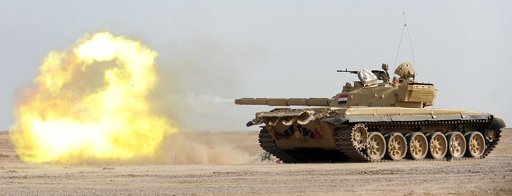

Iraq
Had about 1000 T-72s, M, M1, but also the locally built Saddam and Asad Babil in 1990. After 2003, their numbers had dwindled to 375, and only 125 are listed in the new Iraqi Army.
