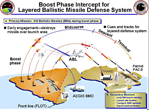

The THAAD system provides the upper tier of a 'layered defensive shield' to protect high value strategic or tactical sites such as airfields or populations centres. The THAAD missile intercepts exo-atmospheric and endo-atmospheric threats.
The sites would also be protected with lower and medium-tier defensive shield systems such as the Patriot PAC-3 which intercepts hostile incoming missiles at 20 to 100 times lower altitudes.

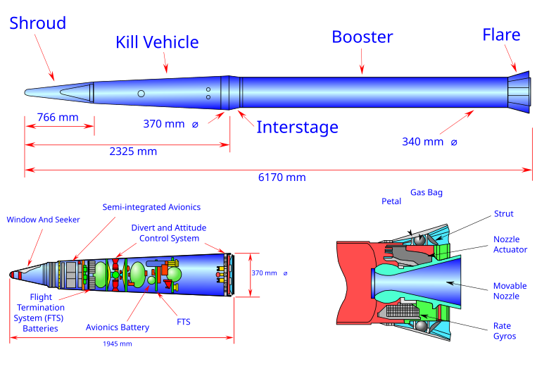

The missile is 6.17m in length and is equipped with a single stage solid fuel rocket motor with thrust vectoring. The rocket motor is supplied by Pratt & Whitney Rocketdyne. The launch weight is 900kg.
"The THAAD (theatre high-altitude area defence) missile system is an easily transportable defensive weapon."
A separation motor is installed at the interstage at the forward end of the booster section. The separation motor assists in the separation of the kinetic kill vehicle (KKV) and the spent boost motor.
The shroud separates from the KV before impact. The KV is equipped with a liquid-fuelled divert and attitude control system (DACS), developed by Pratt & Whitney Rocketdyne, for the terminal maneuvering towards the target intercept point.
A gimbal-mounted infrared seeker module in the nose section provides terminal homing to close in on the target missile in the terminal phase of approach.
During the initial fly-out phase of flight, the seeker window is covered with a two-piece clamshell protection shroud. Metal bladders installed in the shroud are inflated to eject the protective shroud before the seeker initiates target acquisition. The infrared seeker head, developed by BAe Systems, is an indium antimonide (InSb) staring focal plane array operating in the mid infrared 3 to 5 micron wavelength band.

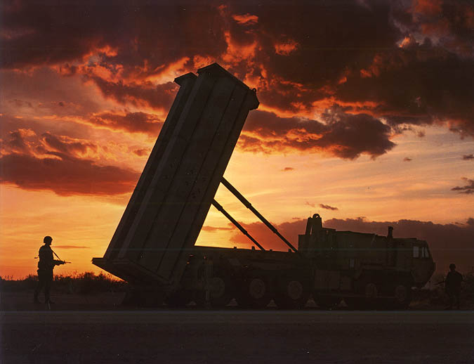

M1075 truck-mounted launcher
There are nine M1075 truck mounted launchers in a typical THAAD battery. Launch vehicle is a modified Oshkosh Truck Corporation heavy expanded mobility tactical truck with load-handling system (HEMTT-LHS). The 12m-long by 3.25m-wide launch vehicle carries ten missile launch containers. While on the launcher, lead acid batteries provide the primary power. The batteries are recharged with a low-noise generator.
After firing, reloading the launch vehicle takes 30 minutes.

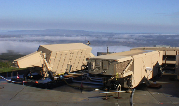

Ground-based radar
The cueing for the THAAD system is provided by the Raytheon Systems AN/TPY-2 ground-based radar (GBR) for surveillance, threat classification and threat identification. THAAD can also be cued by military surveillance satellites such as Brilliant Eyes.
The ground based radar units are C-130 air transportable. The AN/TPY-2 radar uses a 9.2m² aperture full field of view antenna phased array operating at I and J bands (X band) and containing 25,344 solid-state microwave transmit and receive modules. The radar has the capability to acquire missile threats at ranges up to 1,000km.
The first production radar is being tested at the White Sands Missile Range in New Mexico. In September 2004, the THAAD radar tracked a tactical ballistic missile, cueing a successful intercept by a Patriot PAC-3 missile. A second radar was delivered to White Sands in June 2007.

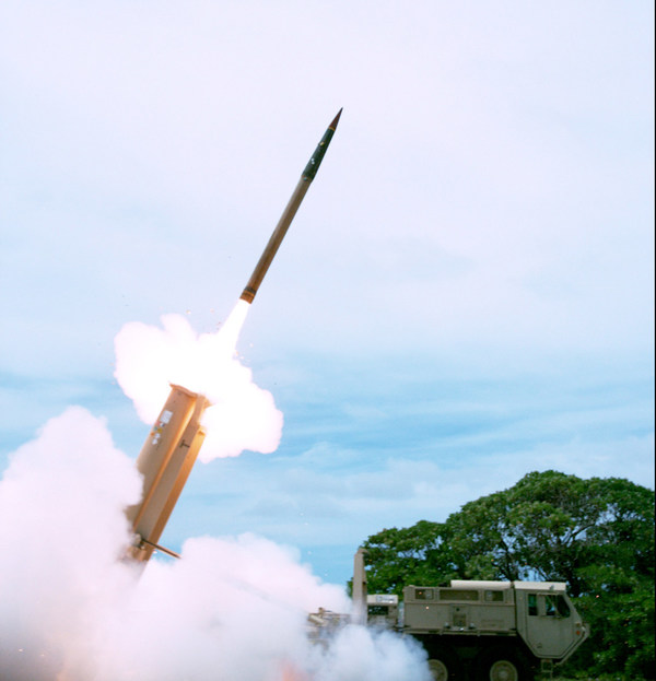

During the test, designated Flight Test THAAD (FTT-23), the THAAD system located at U.S. Army Garrison Kwajalein Atoll in the Republic of the Marshall Islands successfully detected, tracked and intercepted a threat representative target using a THAAD launcher that was positioned at distance from the other THAAD end items.
The THAAD radar detected, acquired and tracked the target. The THAAD system then developed a fire control solution and launched an interceptor from a remotely-located THAAD launcher that destroyed the target's reentry vehicle.
This was the 16th successful intercept in 16 attempts for the THAAD system since 2005.
