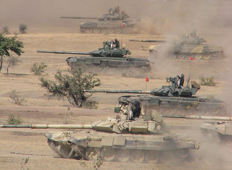

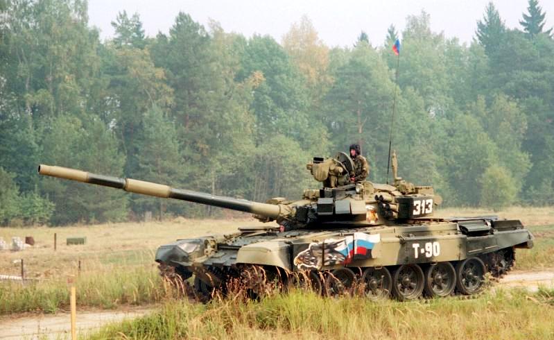

After the start of a mass-production, the T-90S was chosen as an export model, with the usual downgrades. The T-90 was also remarked for its singular “three-tiered” protection level, comprising composite armour (turret), Kontakt-5 (Mark II) ERA and Shtora-1 countermeasures system with a set of evolved smoke mortars and other refinements. This combination really sets apart the T-90 from the previous T-72 MBTs and really incarnates the 3rd generation MBT concept in Russia. The production had eventually ceased in 2015, after the T-14 was first revealed and its own production was scheduled to start in early 2016. By then, around 2260 had been built, which was the lowest production observed for any Russian/Soviet MBT, at a unit price tag of $2.5 million (1999), equivalent to 4.25 million USD in 2011. The T-90MS price was evaluated to 4.5 Million $.
T-90 MBT in a public demonstration in 2012

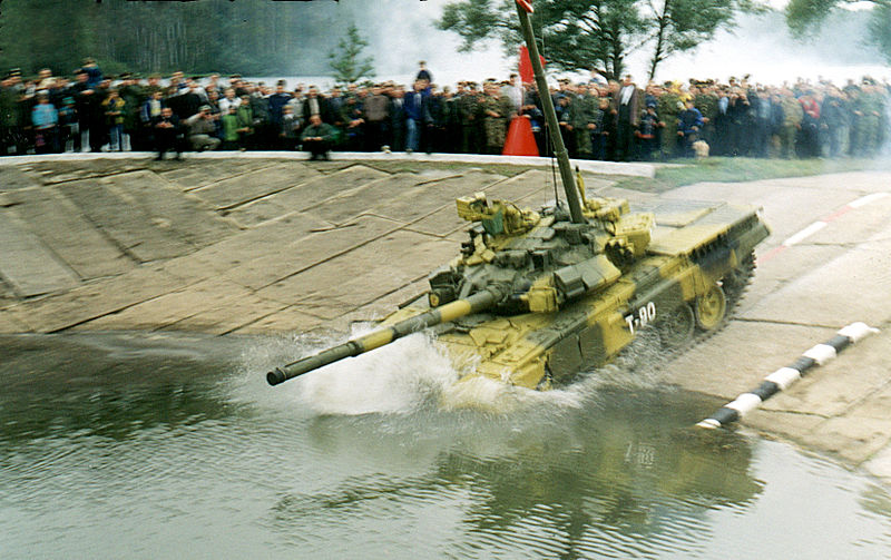

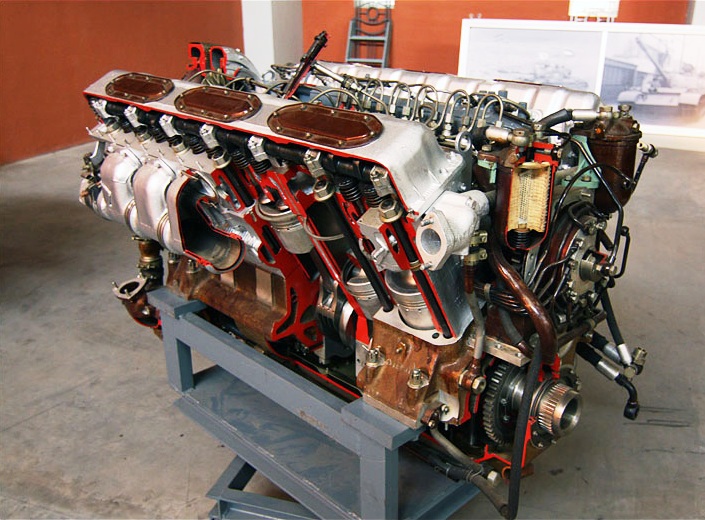

The first production version was given basically the same engine than the T-72BU a proven V12 V-84MS diesel giving an output of 840 hp. It was coupled to a 1 kW AB-1-P28 auxiliary power unit which served several subsystems on board, without starting the main engine. This was enough for this 46 tonnes MBT to reach speeds up to 60 kph and around 45 kph cross-country, due to a power to weight ratio of 18.1 hp/tonne (13.5 kW/tonne). The transmission was manual, with 7 forward gears and 1 reverse. This power was passed onto the ground by the same drivetrain than the T-72B, six doubled cast roadwheels per side, and three return rollers, resting on torsion bar suspensions.
Range was around 550 km with internal capacity of 1.200 L + 400 L auxiliary. Ground pressure was 0.91 kg/sq.cm. Performances were as follows: Fording depth 1.2 m on the move without preparation, and up to 5 m with full preparation and OPVT (snorkel). It was capable to cross a trench 2.8 m wide, a vertical obstacle 0.85 m high, climb a maximum gradient of 30° and stay stable with a maximum tilt of 30°. Like all previous Soviet MBT the T-90 had a simple engine smoke generator. There was also the traditional beam attached to the rear, used for extra grip on the most muddy/snowy terrains. With the addition of additional armour and equipments, the weight rose to 1-2.5 tons and new engines were developed like the 1,000 hp V-92S2 diesel, and eventually the 1,250 hp V-96, giving a 26.3 power-to-weight ratio. Top speed was around 65 kph (governed) but acceleration and torque were much improved.
T-90 in demonstration of its Snorkel.

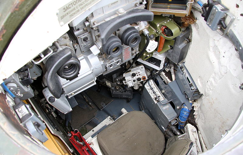

The fire control systems count a 1A45T Irtysh computerized system. Night vision systems comprised the TO1-KO1 Buran-PA main sight with the TPN-4-49-23 passive/active II with an effective range of 1.2/1.5 km. In late production models, this system was replaced by the ESSA (Thales Optronique Catherine-FC TI), also shared by the Leclerc MBT.
The gunner sight is the 1A43 rangefinder, coupled with the 1G46 day sight, the 9S517 missile guidance system for the ATGMs. The turret/gun sensor that feed the 1V528-1 ballistic computer is the DVE-BS wind gauge. The tank commander is given a PNK-4S system, comprising the TKN-4S Agat-S day/night sight (range 800/700 day/night), while the driver is given the TVN-5 IR night/low visibility sight. In addition to the already powerful Shtora countermeasures system, there is a “Nakidka” thermal/radar/optical shroud. Radio equipment comprised the R-163-50U emiter/receiver, while a R-163-50U and a long range R-163-50K are installed on the command type T-90K. For navigation, there is a TNA-4-3 for the command tank T-90K inertial system, replaced in later batches by a TNA “Gamma” GPS/GLONASS system.

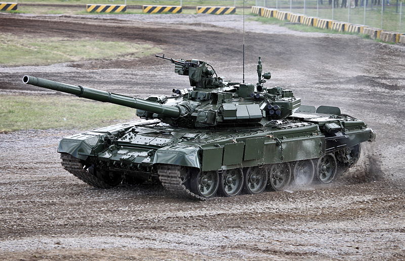

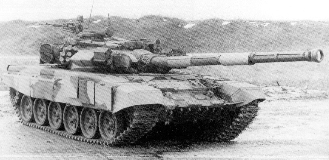

The T-90A appeared in 1999. For the first time, it featured a fully welded turret of the Object 187 experimental MBT; forever breaking the long tradition of cast turret in MBT design. It is called “Vladimir” in honour of T-90 Chief Designer Vladimir Potkin, died the same year. Details of the new protection provided by this configuration (most probably composites) has not been undisclosed. In addition, this version received the new Chelyabinsk Tractor Plant’s 1000 hp V-92S2 diesel engine and a modern Thales ESSA thermal viewer. The T-90AK is the usual command version.
T-90A MBT firing.
The T-90S is the export version, produced by by Uralvagonzavod. They receive the 1,000 hp (750 kW) engine but were in effect deprived of the Shtora-1 passive/active protection system. They also have apparently two different turret armour arrays. In cyrillic, it is shown T-90C. The T-90SK command version was also proposed to export with upgraded radio and navigation equipments, plus the Ainet remote-detonation system for HEF rounds. The T-90S “Bhishma” is a modified T-90S with Indian specs.
The T-90AM is the latest occurence (2010s), featuring a complete rebuilding of the turret, equipped with the new advanced FCS “Kalina” completed by a new ballistic computer and integrated combat information and control systems with digital displays for updated battlefield awareness. There is also a new automatic loader, safer and with a faster reloading rate, coupled to an upgraded gun 2A46M-5 main smoothbore gun. The T-90AM is also the first MBT to receive as secondary armament a dedicated rapid-fire remote-controlled anti-aircraft gun “UDP T05BV-1”, of 20 mm caliber. It is capable to engage helicopters and low flying aircrafts.Protection is also upgraded wioth the new ERA set Relikt, replacing the old Kontakt-5. Lastly, it is equiipped with the latest iteration of the venerable deseil, the V96 1130 hp engine. The turet receive extra diital cameras and captors for an enhanced environmental control system especially tailored for urban combat, and a completely upgraded satellite navigation system.

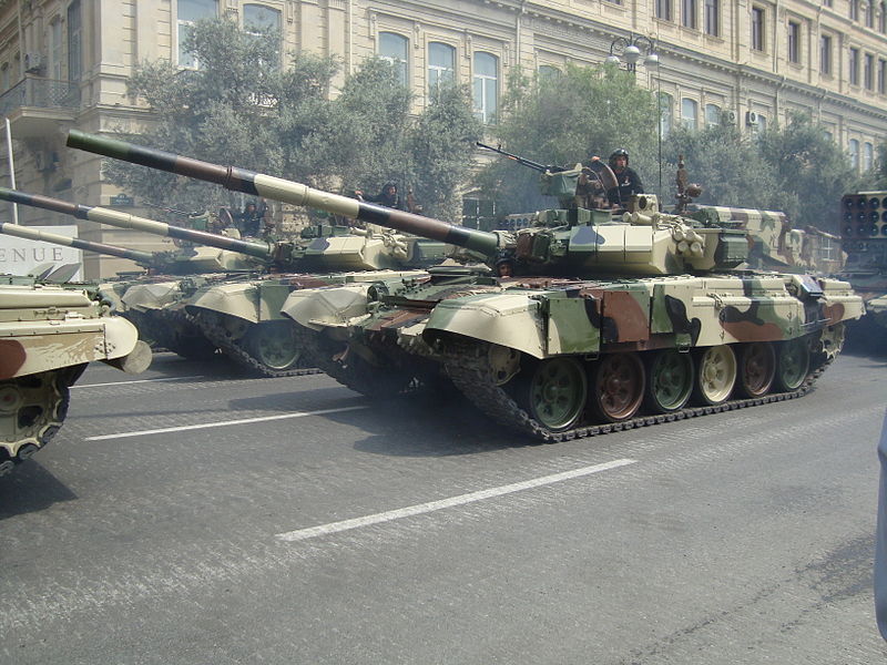

Azeri T-90 in a parade in Baku, 2013.
Algeria
The only country in Maghreb (North Africa) to operate the T-90SA. The army took delivery of 305 T-90SA tanks in a 2008 first batch was delivered, followed by a second by 2013.
Azerbaidjan
The newborn republic adopted naturally the T-72UMG and the T-90SA as their main battle tanks. 100 T-90SA are currently in service, 100 others are in option.

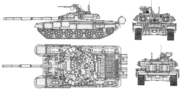

T-90/A/M specifications
Dimensions (L-w-h)6.55(9,530 oa) x2.32 x2.04 m (21.4 x7.6 x6.7 fts)Total weight, battle ready45.7 Tonnes (91,400 lbs)Crew3 (TC, driver, gunner)PropulsionSee notes. V-84/92/96 12-cyl. diesel 840/940/1250 hp
Power/weight 18.1/20.4/26.3 hp/ton
Top Speed (dep. of engine)42-65 km/h (37-40 mph)Range (dep. of engine)550-700 km (340-430 mi)ArmamentMain: 2A46 125 mm sb gun + ATGM
Secondary: 12.7mm Kord Heavy machine gun, 7.62mm PKMTArmorSee notes. Dolly Parton+ERA Kontakt 5+ShtorTotal productionApprox. 2,260
